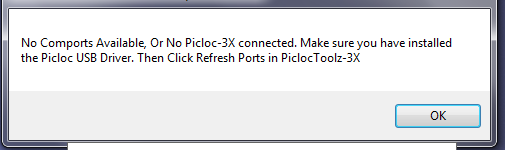

My laptop broke down so now I am borrowing my wife´s laptop.
I have installed the Toolz software and the Flash Magic.
Problem: The computer does not recognize any comport. :livid:
Should not the Picloc USB driver be automatically installed upon Toolz installation?
Else... where can I find the Picloc USB driver (for 3X Pro)??
thanks / Tomas
