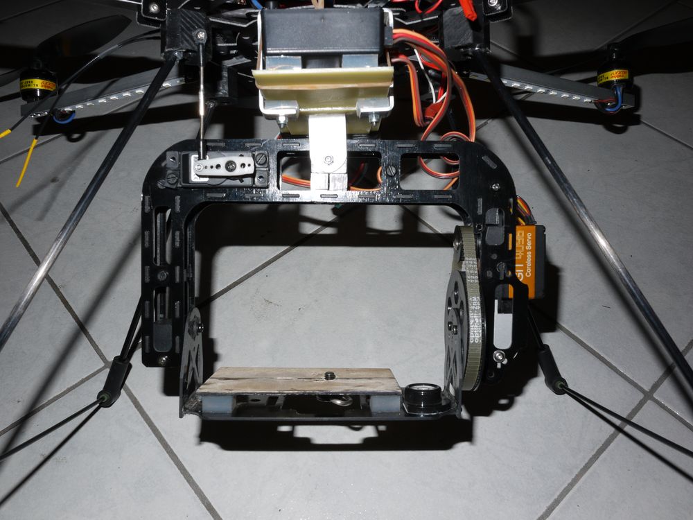

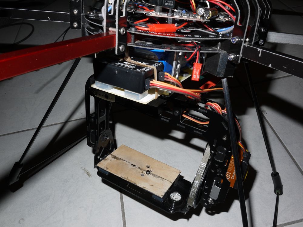

hexacop
HexaCop
@HexaCop thanks for the comparison. What servos are you using on your mount ?? Still seems a bit too bumpy. Picloc can do much better. Can you post a picture of your mount ( or send it to me by email )[/QUOTE]
Hi George, thank you for the input, see pictures below:
I'm using Savöx SC 1257TG for tilt and 4:1 gear ratio with external potentiometer.
Roll servo is MKDS18
The battery and the Picloc is mounted on the same board and the board is decoupled with alpha gel from the frame.
The picloc itself is mounted with additional alpha gel on top of the board.
The camera is decoupled once more with alpha gel.
The propellers are balanced and I do not see real visible vibrations on the frame.
It was too windy today to do another test, but I will further decrease the acceleration and try again.

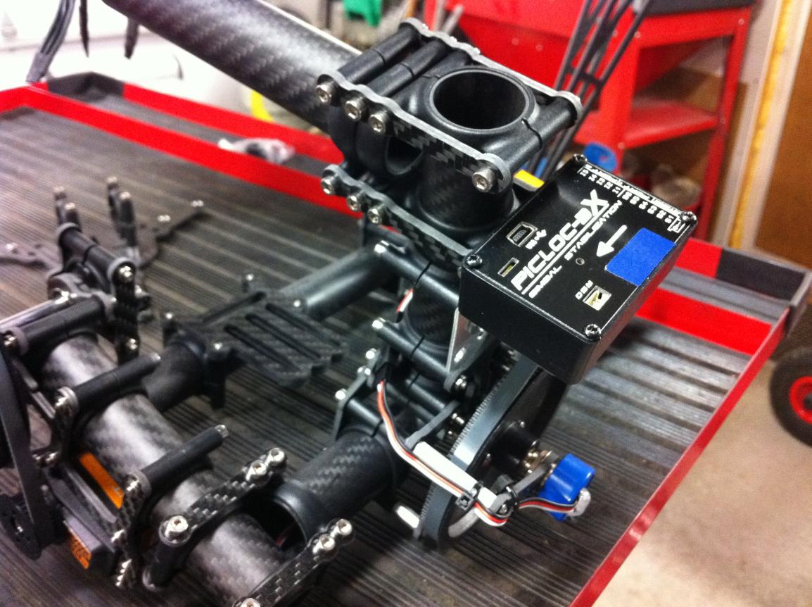

Hi George,
i hope its okay if i post this info from one of your emails ?
George Email
If you want to make test like the PhotoshipOne's 3XPRO video on my website frontpage, you can mount the Picloc-3X on the Cameraplate.
Just disconnect mechanically the pots ( leave them dangling for now), and set the Picloc Servo output to 1500us from the servo matrix selector ( item before Tilt, ROll, Pan etc etc selection in the servo tabs )
Center the poti so that the servo is still on 1500us output from Picloc.
I would like to also try this version, can you confirm it is already working ? and is the way i mount the picloc in the picture okay ?
Concerning the settings for gains I am confused would i still drive the setup in proportional ?
Stated this here and not via email because it could be helpful for some others
By the way i got the picloc standard today and thanks for the candy :)

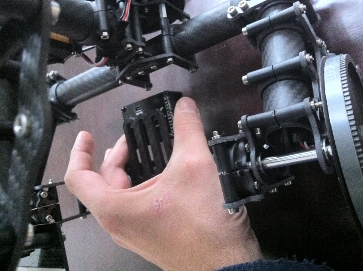

@Boris : Yes.. That is correct. In fact anywhere on the Tilt axis is fine.
The way you photographed it seems like a neat way of installing it on the cinestar gimbal, with just a piece of double sided tape...leaving the USB accessible.
In similar cases, when installing Picloc on the inner axis and therefore, with 360 servos,
it is important to mount Picloc as rigidly as possible to your camera mount, so that all movements are sensed by Picloc accurately.
This mounting method can then afford to have very 'loose' vibration isolation on the roll and tilt axis from the mount's hanging point.
However, if also stabilizing PAN, it is important that your vibe isolation system has lateral only rigidity.
In larger and similar stabilizing systems, the hanging point is actually a CV joint , or a Universal Joint ,
such as used in this type of stab system here.
You can see that it is really free on the Tilt and roll axis... yet rigid in the PAN axis.
Hope this helps :)
Hi! Im new to this forum, but has been following this thread with interest!
I reflected on the mounting of Picloc on the CineStar gimbal, as I myself made a little shelf for the Picloc on the firm vertical boom..
(No risk twisting the cables i.ex.)
Would like to understand more about the preferred mounting on the tilt axis?
Thanks in advance,
//Lars in Sweden
