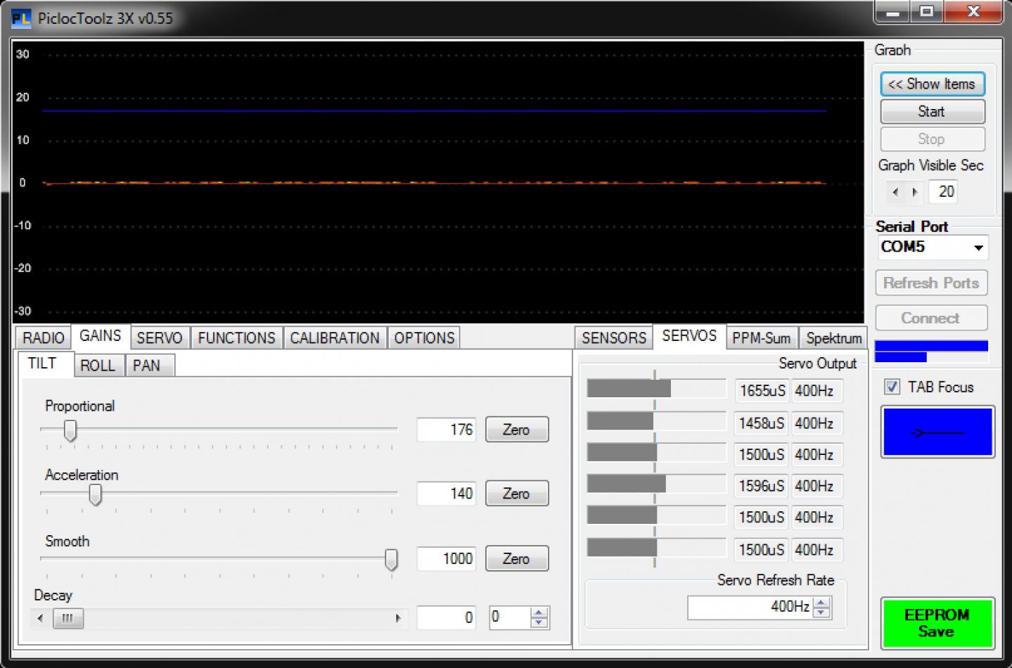

Maybe this helps,

holco
Hi Boris,
Like I previously put, [FONT=verdana, arial]you have to change the roll pot for a 3 turns, if not you can forget it to get good roll response!!
[/FONT]
Also set your servo refresh rate to 400Hz.
I uploaded the tilt settings also next to the roll settings.
regards,
Mario
Hi Holco,
thanks i dont have the Av130 mounted any more, but i will again on my hexa. My settings weren't to far of for the AV 130 like you have them now. Hmm but i cant get the same results certainly not on fast movements.
Boris
