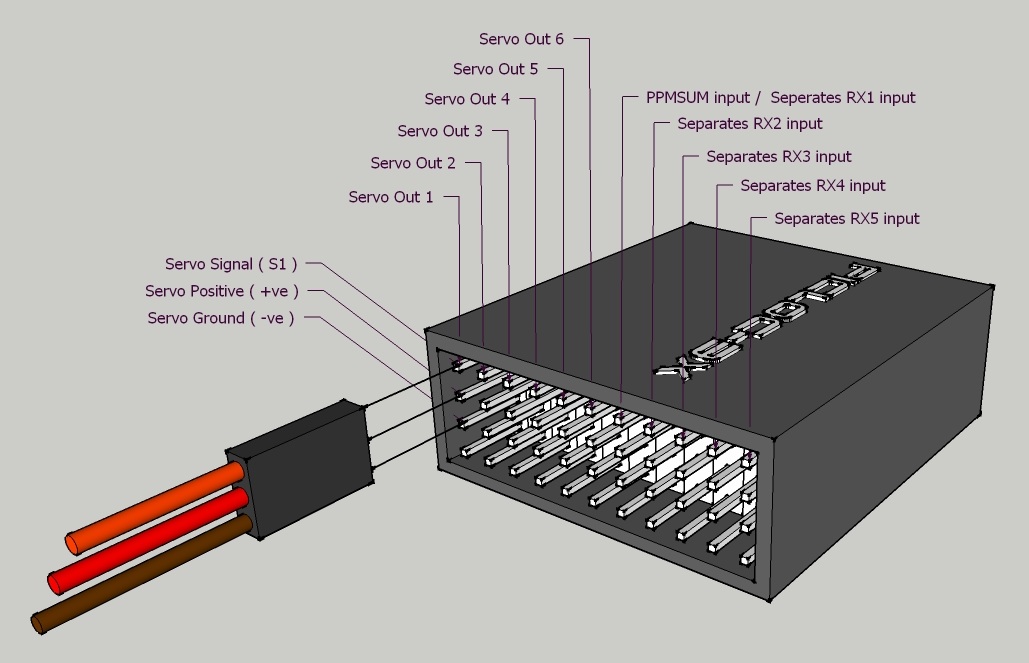

If you run a futaba 'traditional' receiver, you have to select 5R/C from the Options Tab ( orange ).. and plug Tilt, Roll, Pan, and Throttle(or a switch ) to i1,i2,i3,i4 on Picloc ( RX separates input )View attachment 2147
For PPM SUM, you need to have a receiver that outputs PPMSUM...
I use Jeti Duplex TX Module for Futaba + Jeti RMK2 diversity receiver, and this allows me to Have a JetiBox wirelessly connected to my Picloc.. for tweaking/tuning purposes.

First... verify that your input channels are coming in:
but.. to see something...
You must have '5 R/C' selected in the : Options Tab -> Radio Type. ( seems you done this already)
Then go back to Tab 'RADIO' and select 5R/C tab, and you should see a graphic representation of your input channels ( separates ).
When I was on PPMsum I could get what ever channel on the Rx I was plugged into to show on the picoloc toolz. When I swithed to 2) i1-i5 RX ch input, and 5R/C, All I get are the yellow lines to the left of center and no signal being picked up. Swithcing back to ppmsum, the i1 channel picks up signal and stick input.
That's the problem. I went ahead and flashed again. I thought I had flashed, but must have spaced something. Anyway. first sticks are working now. I don't see Aux 1 working. I have it on Channel 7 with it set to a 3 way switch G. More advice needed. Under radio servo screen, switch is working.
GeorgeM
AUX1 ( for now ) is a toggle function.... ie.. to e-stop.. flick once in a direction, to disable, re-do same movement.
I cannot understand.. now...if you're using separate RX channels or PPM-SUM.
If you're using PPM_SUM, select your AUX1 to take its input from your Channel 7.
If you're using separate RX input, then channel 4 should by default be your AUX1.
