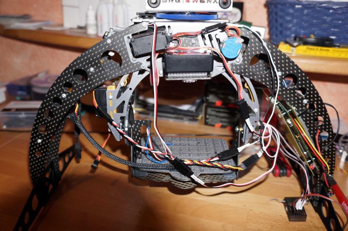

Hi,
I installed the skyline into a AV130 and everything wired. The LED lights up red, yellow and then green. There is no servo moves. It stands still. When my friend of mine has the same problem. I've tried it with the firmware 1.1.3 and also with the version 1.1.4. In my case does not move a servo. Does anyone know the problem?
Tilt Servo to Skyline Tilt Servo
Tilt Poti to Skyline Tilt Pot
Roll Servo to Skyline Roll Servo
Roll Poti to Skyline Roll Pot
Pan Servo to Skyline Pan Servo
Input Tilt Servo to Receiver (Receivers with 5.00-volt)
So I connected it.
andrewrob
