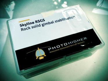

Hello all,
this is for subscribing to this Thread, got mine today, but it will stay there in the Box until you've made positive comments.
Wanted to say thanks to you out there, testing and sharing your skills with it
best, meme
