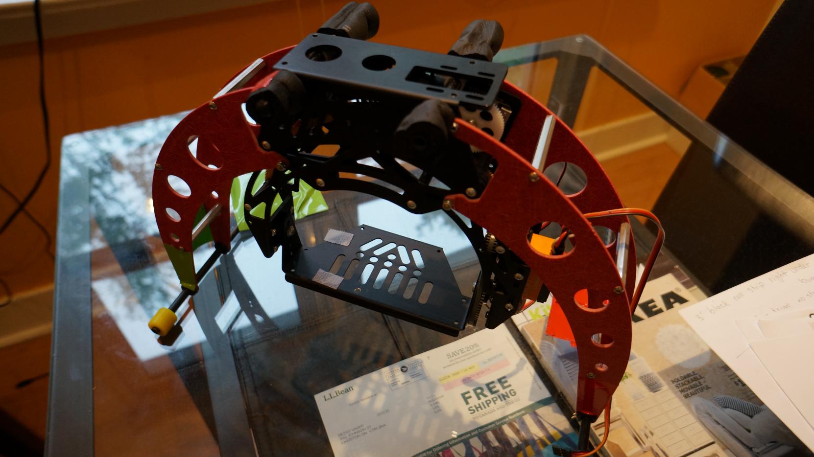

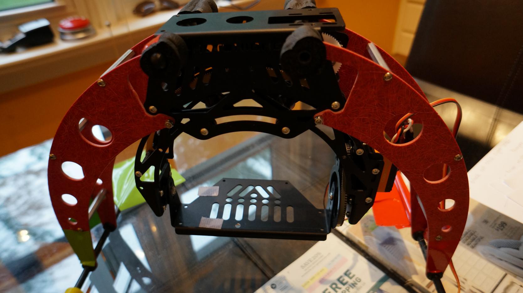

I have one or 2 AV130's for sale. One needs a Savox servo.
This one comes with the stand as seen in pic. Its barely used. The reason is that I upgraded to a Zen, and am not planning on using these any longer. Works well.
One of the 2 comes with the RSGS, the other not.
So, the one in the photo, has the pots in, and comes with the stand, barely used, for $650 plus shipping.
The other one that needs the Servo has no stand, but has the RSGS. Not sure what I want for that. Let me know if anyone is interested.View attachment 13146View attachment 13147
