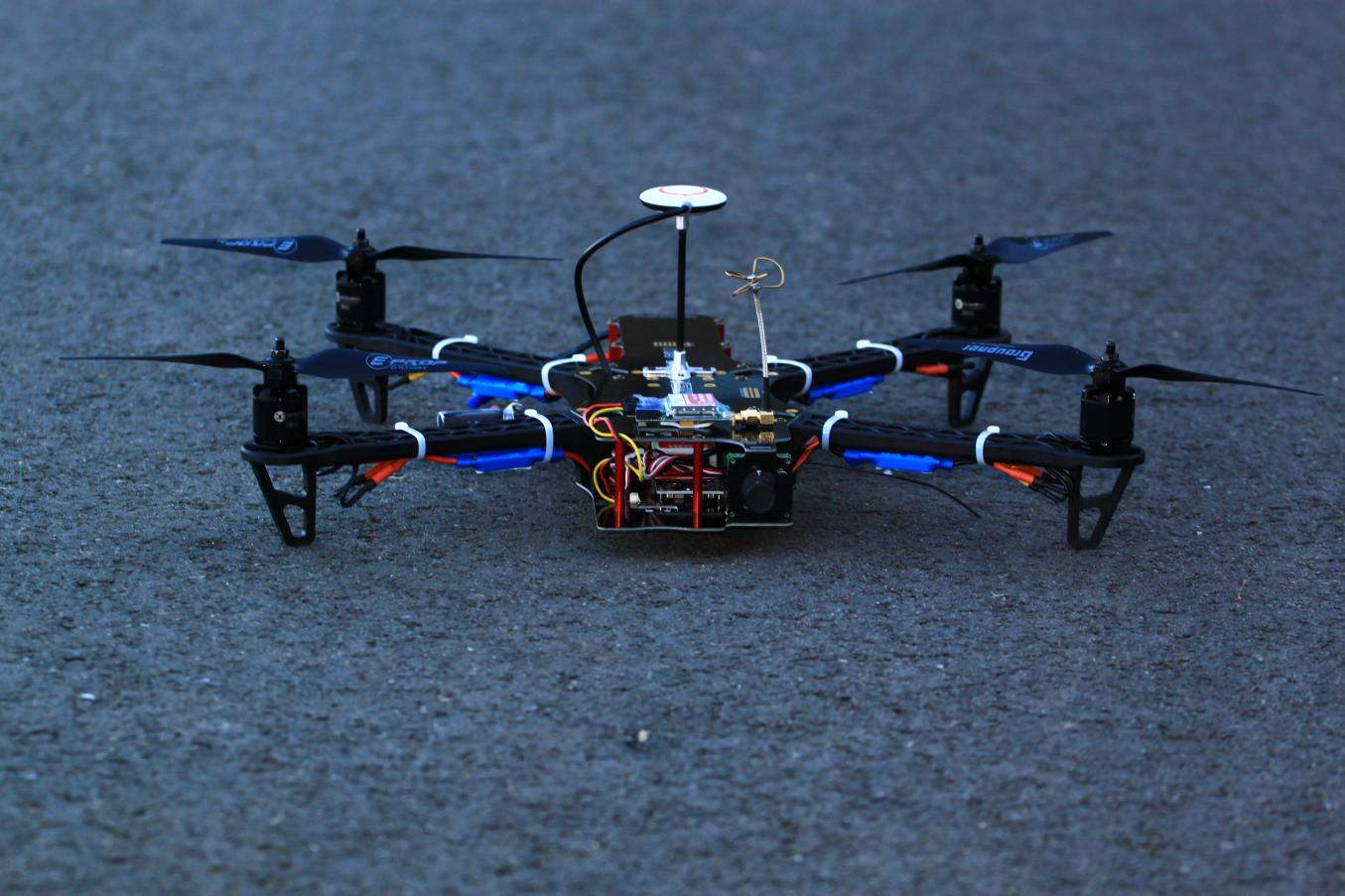

Proof it flies above 6"
Gopro taped on only to the top of the u/c arch... crooked ;)
First flight in any wind - 10mph and it flew beautifully. I treat it well (as though it always has a camera on it) and it should keep flying like this. The wind will be up over the next few days so time to try some narrow-blade props.

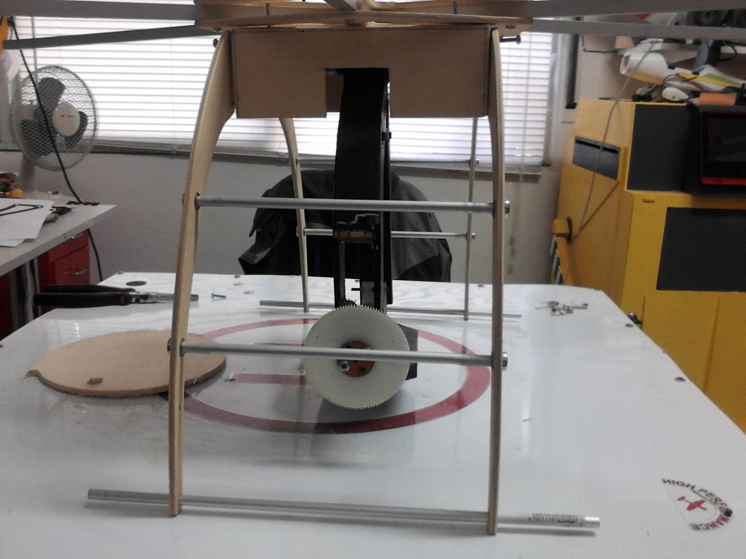

I put my new diy gimbal on the VM-6 with RX100 camera yesterday but I left the servos disconnected until I solder a ubec for them. I am using the gimbal control from the HoverFly Pro FC and I will not run the servos direct... just in case one stalls. I am using an Align DS610 (Savox1258) on the roll and the stall current would kill the FC!
I had a fly with the RX100 Steadyshot off and I have no jitter / jello at all. I am really happy with that :) I'll get the servos powered up tonight for flight testing tomorrow - and then we see how good the servo / belt system is!
All-up weight???
VM-6, 4S5000, camera and diy 2-axis gimbal 3400g. 7 minutes of steady climbing, hover etc.
2x4S4000 (8000mA) 3800g for 10 minutes "active" flying.
I am still using the 12x6 cutdown to 10.5" props for a 45% hover. It is so nice to fly...
I will continue to fly my diy octo as my stills machine while I experiment with this. I plan to build a "good" gimbal following my diy build once I know it works.
