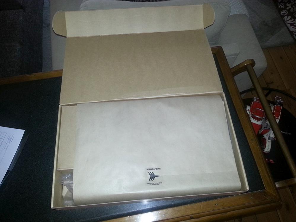

Hey, unwrapping the box is like something from a boutique fashion shop, with brown recycled tissue paper and droidworx stickers.
My wife said "Their attention to detail is fantastic"....
Sorry, this is your build blog, I'll start my own eh?

Start an XM build blog... it's all good info for those that want to see how good DW builds are. U get chocolates in yours? I got chocolates! (and spare parts that I shouldn't have that I'm returning... I'm too honest!)
Attention to detail was awesome. You can tell the women in the team do the packing!
