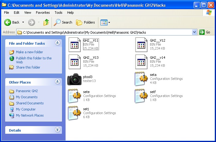

1. the Windows folder containing all the necessary bits for ptool3 and the hacks to work. I have labelled mine 'Hacks' and the contents are:
GH2_V11 is the original GH2 firmware
GH2_V12-14 are my hack infested substitutes
ptool3
seta - sete - setf - setj are the hacks that have been downloaded and unzipped. They mean Set A, Set E, Set F etc. and refer to the ten hack positions available within the pTool3 programme

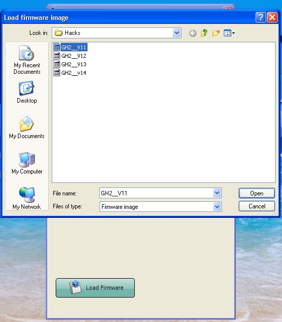

2. Double Click on the ptool3 icon in the 'Hacks' folder to open this window and then click 'Load Firmware'
3. This dialog opens, navigate to the 'Hacks' folder and select the original GH2 firmware, i.e. GH2_V11

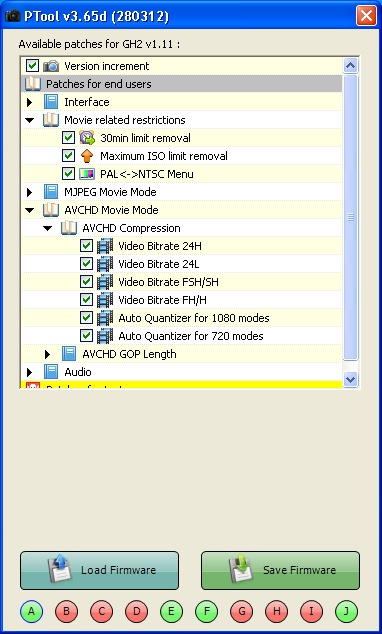

4. This is the ptool3 window that opens. In the main window are the various parameters that can be messed about with - labelled 'Patches for end users' and 'Patches for testers'.
At the bottom is a row of ten circles. Those that are coloured green correspond to the seta, sete, setf etc that reside in the 'Hacks' folder and which have been recognised by pTool3.
5. A patch is loaded into the programme simply by clicking the relevant green circle. Whatever adjustments and changes have been made to the original firmware by the author of the patch are now loaded into the pTool3 window for viewing, or changing parameters if you so wish. Whether you just use the pre-configured patch, exactly as downloaded, or make changes to things the process of transferring the data to the camera is the same.
6. Click 'Save Firmware' and choose virtually the same name as the original firmware but advance it by one (GH2_V11 is the original, so save the new one as GH2_V12).
A new file will now have been added to the 'Hacks' folder. Copy that file GH2_V12 to a blank SD card and then watch the video at the end of this and follow the procedure as explained to load it into your GH2.
