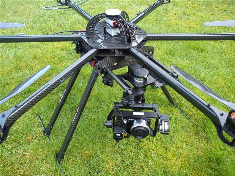

3 months overdue, today I have finally received my Skyjib! (from a company which I will never be using again.)
I've been trying to get the AV link to work, and having some issues.
I have the camera attached to HDMI with HD->SD converter and then to the Stinger pro.
There is a connection as the monitor is showing colour bars, but there is no image coming through. (see pic 1)
I have the GH2 in 24p mode, which from what Mombasa and Tim say, will give me live images.
It will however give me images when i enter playback mode with the camera. (pic 2)
Any suggestions?
thanks View attachment 8760View attachment 8761
