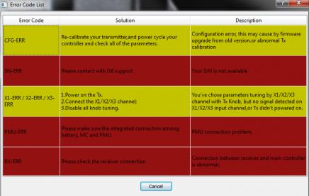

Howdy all....next installment in the saga! Package arrived this morning with the DX6. Interestingly the NAZA GPS module was not included (never buying from that supplier again :( ).....so while I go back and try to get my GPS sent on, thought I may as well play around.
Frustratingly, didn't get very var! RX connected up fine (had to file down the little tabs in the NAZA wires to get them to plug into the AR6210 RX. Then went to bind the TX/RX and realise the that bind plug was not in the box. Me thinks the supplier has either taken it out of the box for someone else or I have been given a second hand one....GRR!...
So, fashion a bind plug myself and successfully complete the binding. Power up and connect to the PC for tweaking with the NAZA software and I am greeted with this!
Did some quick googling to try to figure out the problem and nothing there other than check all wires and connections.....which I have done and all appears in order. Have to go to work now, so would appreciate any pointers for when my efforts resume later!
Considering my experiences with the supplier, the SN-ERR seems a bit fishy?

False alarm, did some more playing around and it actually corrects itself once you go through the calibration procedure and write the changes. Pretty weird set of error messages to display....would likely make a lot more sense to have a more meaningful message!!
