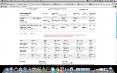

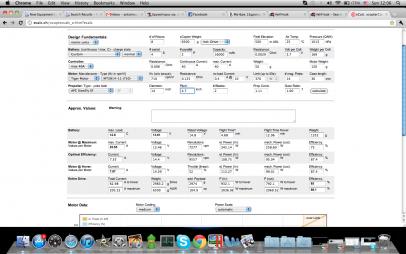

Guys a question..>!
I have 2x4s 8000mah on the CS 8.... i have the tiger motors 710..
I have baught and 2 x5s 8000 as i have seen a lot to like this motor with 5s and 14x4.7 what do you think??
CHeck the screenshots with the 5 and 4s setups//!
