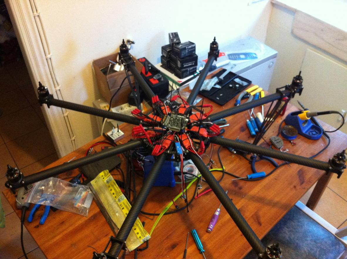

GUys now something about the build when you level your motors you are doing is with eye level or you use a pitch gauge??
Is there a problem for 0.1o and 0.2o
Thank you
To level my motors, I took off the landing gear / gimbal and put the Cinestar on a large flat surface with the arms a bit loose so I could make sure that all the motor mounts were flat to the surface they were sitting on. Then I tightened each one up. Hope that makes sense.

Guys thank you for your help...!!!
I will tell you some more steps i did in order to tell me if i am ok..!
First of all i calibrated and setup all me escs...!
Secondly i upgrade my HFP to V 4.0 with update client..! SUCCESS :) :)
Thirdly i connected the escs and the reciever as per the manual...!
I put mode +Octo
Thats all till now..! THen whats the next step to check the direction of motors and to setup AL as per this tutorial??
https://hoverflytech.zendesk.com/entries/21202158-how-to-setup-autoleveling
I am readind the manual about the EPAs...!
The Gear channel one EPA is the gain for Normal FLight with auto levelling Off..! The second is the gain of the Auto levelling right??
THe AUx 1 now is the Alt hold ON and Alt Hold OFF...! Right??? This switch i have to change in flight...! CAn i have it always on ( i am just asking)
also on SPektrum on the EPA you can see +- on the futaba that i dont have +- how can i undestand where is the Alt ON Alt oFF and AL ON and AL off??
