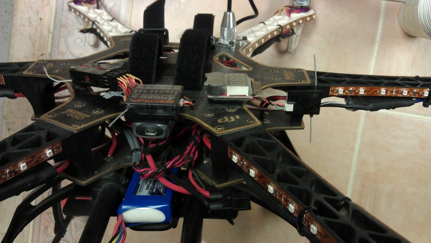

Am I correct thinking that the little arrow in the corner of the Herk board should be in line and facing the nose of the ship?
baja-king
Here for the ride :)
it doesn't matter really... I made a mark with a pen on mine so that if I removed it I would know where to put it back in relation to the motor wires...

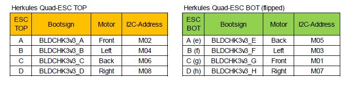

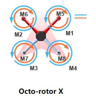

I have a question about the Herkules III, i am setting up my I2C Motor mapping addresses, i am OK with writing these into NVRAM but appear to have a conflict in the motor layout between DJI in the WKM manual and the instructions from Andreas and i don't know which way is correct.
DJI say.....
But the instructions from Andreas appear to contradict this with
View attachment 12863 View attachment 12864
So DJI have all top motors turning CW (in relation to viewing as per the diagram) and all bottom turning CCW and the motor sequence from front R/H CW 1&5 then 4&8 then 3&7 and 2&6.
According to Andreas (and the instructions are written with reference to the WKM) the sequence is very different, he has (again CW from front R/H Boom) 8&7 then 6&5 then 4&3 and 2&1, he also shows the top 4 motors alternate and counter rotate as do the bottom 4.
Can i ask how you have yours setup? Did you follow DJI in relation to the boom/motor locations? maybe Andreas way is better for resilience but as the WKM will be doing all the thinking it seems counter intuitive to ignore the DJI setup.

Hi Ches, this is how I did mine as per the DJI setup:
attachment.php
Top Herk board:
A=M3 (CCW)
B=M8 (CW)
C=M1 (CCW)
D=M6 (CW)
Bottom Herk board:
A=M5 (CW)
B=M4 (CCW)
C=M7 (CW)
D=M2 (CCW)
This is setup so that you have some redundancy should 1 of the Herk boards fail...
Once you setup your Herk and motors as above you will need to check the rotation direction is correct for each motor... eg 1,2,3,4 counter clockwise, 5,6,7,8 clockwise
If any are wrong then just swap 2 of the 3 motor wires around for that motor and it's direction will be correct :)
Cheshirecat
That makes perfect sense as per your setup, i had the top Herk handling all the top motors and the other the bottom. I can see why that would not give the right redundancy.
Time to get the serial to USB Cable out again.
