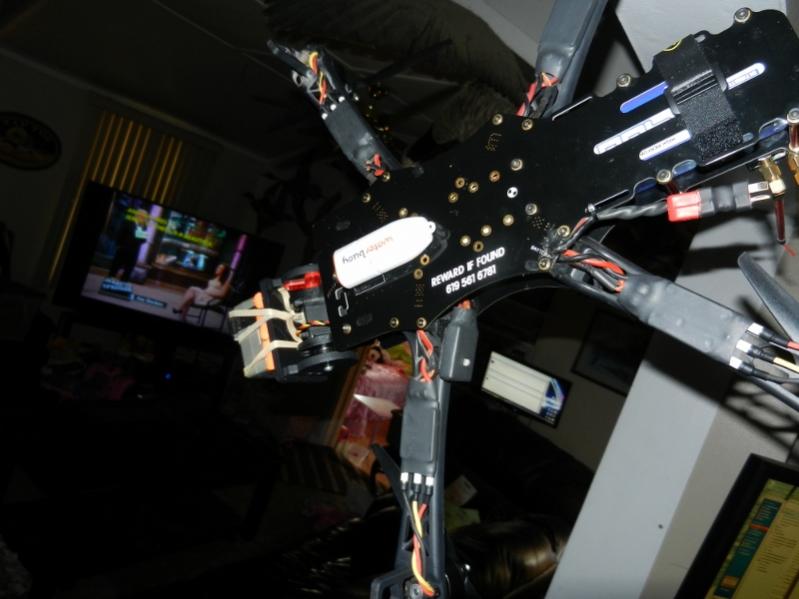

http://www.water-buoy.com/
lifts 2kilo each, looks like this under a discovery. little longer than a cig lighter, but about that size
