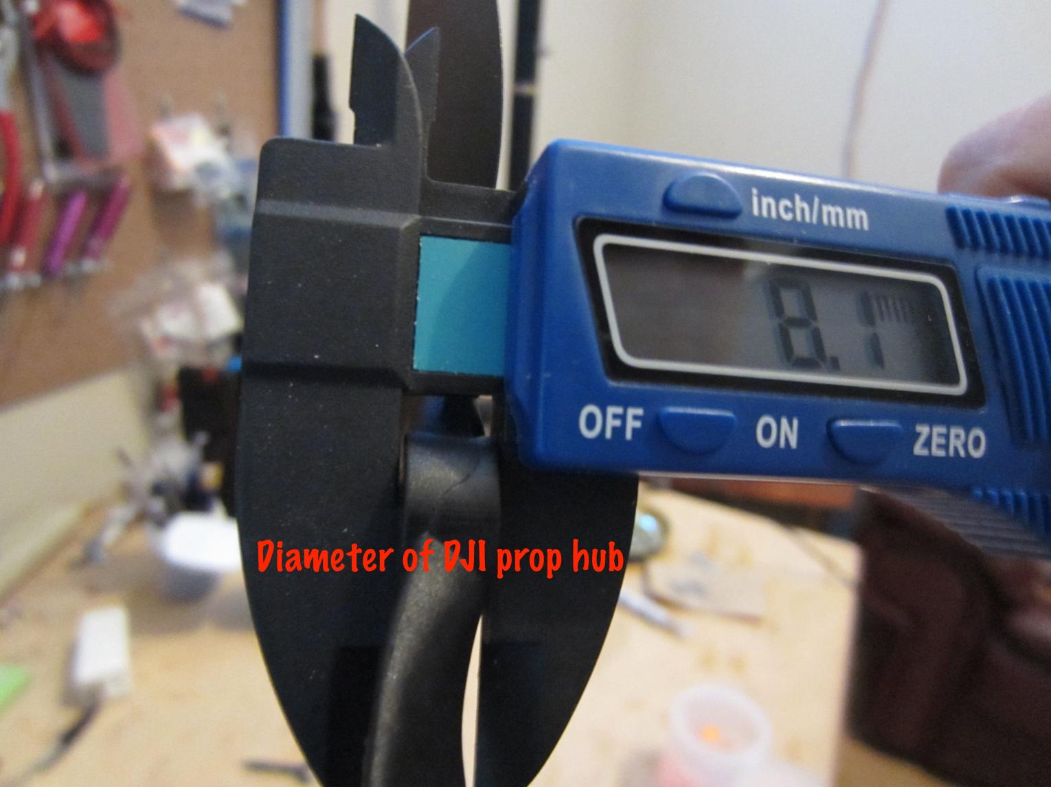

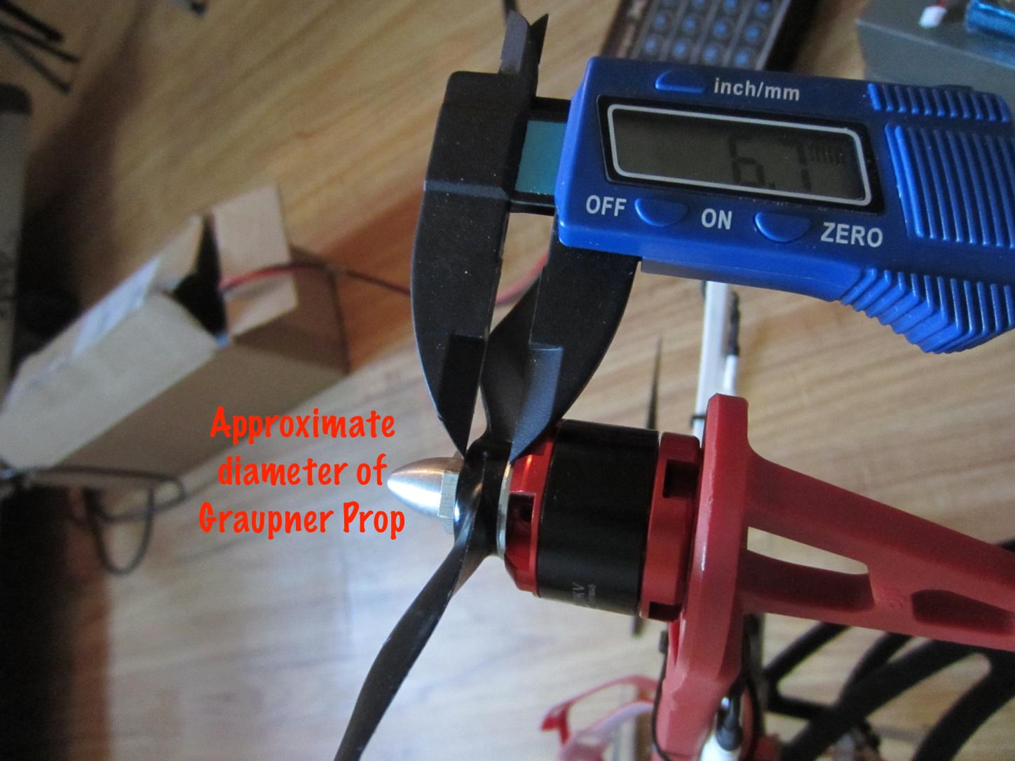

Also, I'm not sure you need to counter sink the holes in the prop nuts/spinners. Personally I used washers that sit between the top of the motor and the bottom of the prop hub. The reason for this is the hight of the prop hub on the Graupner props is not as high as the hub on the DJI props. Therefore the propnut/spinner cannot lower far enough to put enough on the Graupners to hod the prop tight. By adding a washer you lift the prop by about one mm, this enough for the nuts to meet the top of prop hub to make a secure and tight fit. Make sure the washer's inner hole diameter is as close to exact as possible so to no unbalance the motors/props. I took my F550 to the hardware store and tried many washers until I found an exact fit for all 6 washers.
View attachment 5916View attachment 5917
Hope this helps.
