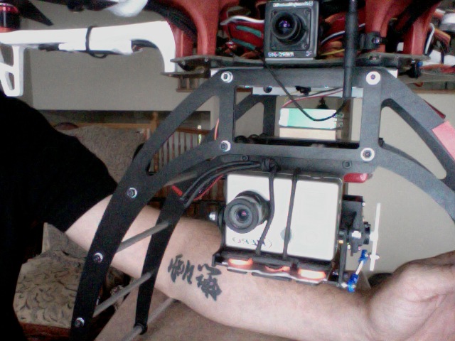

Yes I'm using the earplugs as dampeners but I think they were too tall, They were about 10mm - 12mm in hight. So I cut them down to about 5mm. I took your advice from before and mounted the camera plate separately from the gimbal View attachment 6082 separated by the earplugs. I hope the shorter bits of earplugs will help.
I have updated my Firmware and selected 100Hz for the gimbal servos, seems a little smoother (yet to test it though). The Savox HS-255MG are 70Hz but 100Hz seems fine, I'm hoping this will help to.
I think I'm going to put some expo in my cyclics to make the movement a little softer, and lower the gain on the gimbal servos. If this doesn't help then I'll have to get a new GoPro lens, I got the Sunex to replace the original lens I scratched, it was about $50. cheeper.

So on your mount, try different amounts of earplugs, different lengths, somethings gotta be better than that. looks like mine did right before i got it
man that cam is old, no display. is it lipo or regular battery?
on mine what i've found is it like the earplugs on there side, helps to make a support for the cam and it really really likes a loose rubber band. soft, loose, not very tight, almost not squishing the plugs at all seems best. That's why trappy is always looking for gopros, runs em so loose they fall off, but i got mine just a hair tighter so it barely wants to squish a foam plug.

The cam is not that old, it's just not turned on. The lens is the sunex and I put tape around the lens because there is a space between the lens hole in the camera and the lens' outer diameter. The tape is a kind of dust skirt.
I was thinking about turning the earplugs inverted, but thought most of the vibs would be absorbed in the thicker end of the earplugs, that's why they are turned that way. (Will try your suggestion next.)
ShoeGoo is holding the plate onto the earplugs and double sided outdoor tape is holding the earplugs to the base of the gimbal.
From top to bottom
1.Camera
2.Plastic camera plate
3.ShoeGoo
4.Earplugs
5.Double Sided outdoor tape
6.Camera gimbal

ok, use shoe goo as little as possible but enough to hold the plug, i'd bail any tape, light on the glue, and put it like this
1.Camera
3.ShoeGoo
4.Earplugs
5.ShoeGoo
6.Camera gimbal
orientate the plugs like this
i.php
I've had so many varrying results on end and alot more consistency on there sides
gimble
except i lengthend the bottom plate and put a bed of them plugs like that. Went from zero to hero for a gopro
you know that band on there,,, is there a way to make it either a wide one really loose so it just barely compacts a earplug or a super thin soft one a bout the same. you don't want the plug smashed, super important, then if it's too loose, it jiggles. Theres a just right and the less it is the better. Guys that get away with velcro is usualy why. something about having tension and any harmonics across the front of these things drives em nutts. tight bands and hard bands are bad, even if there on the isolated side
This one worked flawlessly, still does. The kid that bought it crashed it, changed arms and props and flew it again with no jello in 1080p. That frame is the one to have,,,,,,,, crazy i fell on the layout so good..
that rubber band barely touched and i believe by the end of that trip the band wasn't being used. that's camera velcroed to like what your base is ditching the band you use now
a really big part was the length of them plugs and how not being compacted but the camera floating on them is what made it work
