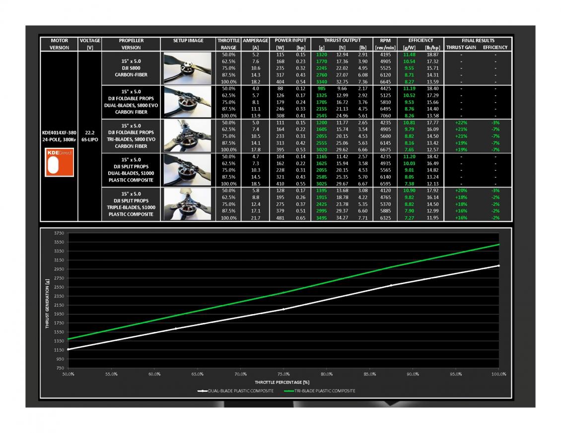

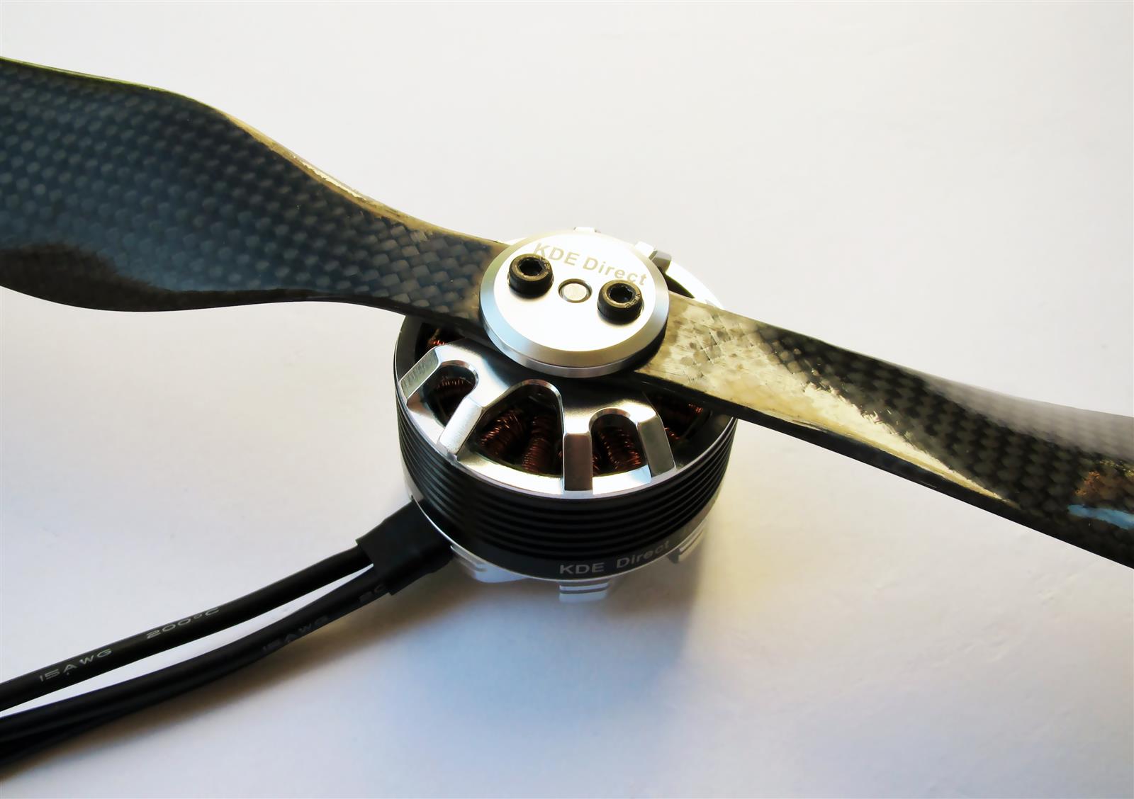

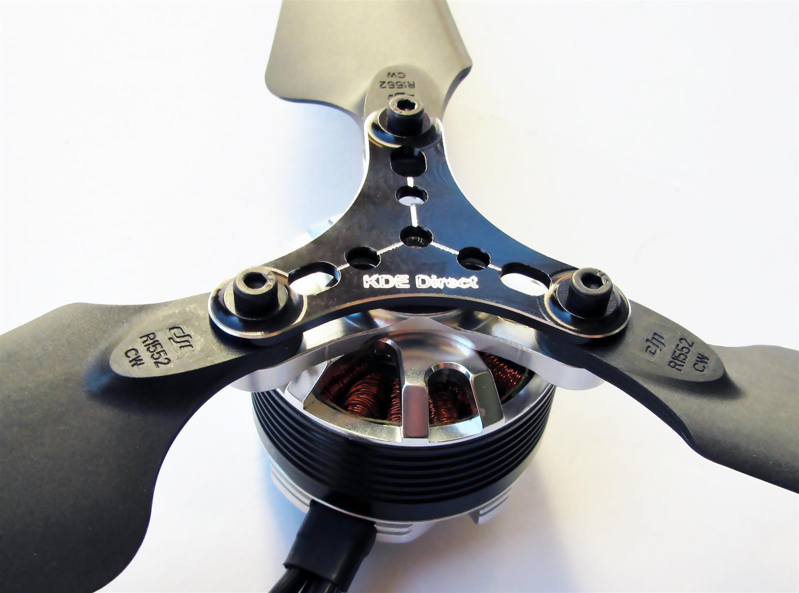

Hey Guys,
We are soon releasing the KDE Direct XF Dual-Propeller and Triple-Propeller Adapters for the Multi-Rotor Series, that utilize the current DJI split-props (both carbon and newer plastic-composite versions). The goal of the project was to provide the ability for higher-lift capacity, in setups that are limited in propeller size. Such as the DJI S1000, the propeller size is limited to 15" to 16" maximum, and by upgrading to the Triple-Propeller Adapters we offer, this capacity is increased 22%-16% (depending on the throttle range and propeller type), with only a cost in efficiency of 2%-7%. That's an amazing gain in performance, and has distinct advantages for multi-rotors that have already been proven in other industry's, such as full-size helicopters and airplane propellers.
We'll be announcing these in the next week or so for public release, and pricing and availability will be provided as well. Thanks everyone!

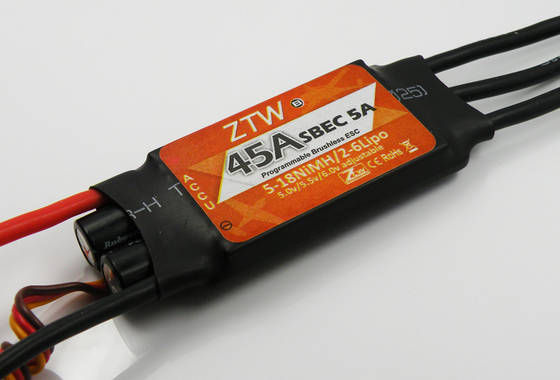

Thanks KDE,
At this point I have some ZTW 45a Simonk esc' - http://ztwoem.en.ec21.com/offer_detail/Sell_45A_ESC_For_Multi--20544332.html?gubun=S, that I am going to use on a hexa or Y6 configuration with the goal of flying a mirrorless camera (Sony NEX or similar) on a GotHeli gimbal. Right now the hexa weighs in at 2240 with landing gear and SunnySky 2814-700kv motors which I'm planning on swapping out for a larger motor that can run 6s. I'm gonna guess the all up weight will be around 4k-5k when finished and wondered what motor/prop you would recommend here. Also, will the ZTW's work with these? I can't seem to find what refresh rate these have...
Thanks again.

Hey John,
The lightest motor we have at the moment is the KDE4012XF-400, which will be much more powerful and efficient than the 2814s you are currently running. In terms of the ZTW, I don't have any personal experience with this series, but my understanding is they are the same manufacturer as Maytech (?) and we've ran the motor with their SimonK editions with good success. The versions we were testing originally were the SimonK 400Hz editions, and they worked well in combination with the KDE Direct XF series motors.
Hope this helps,
