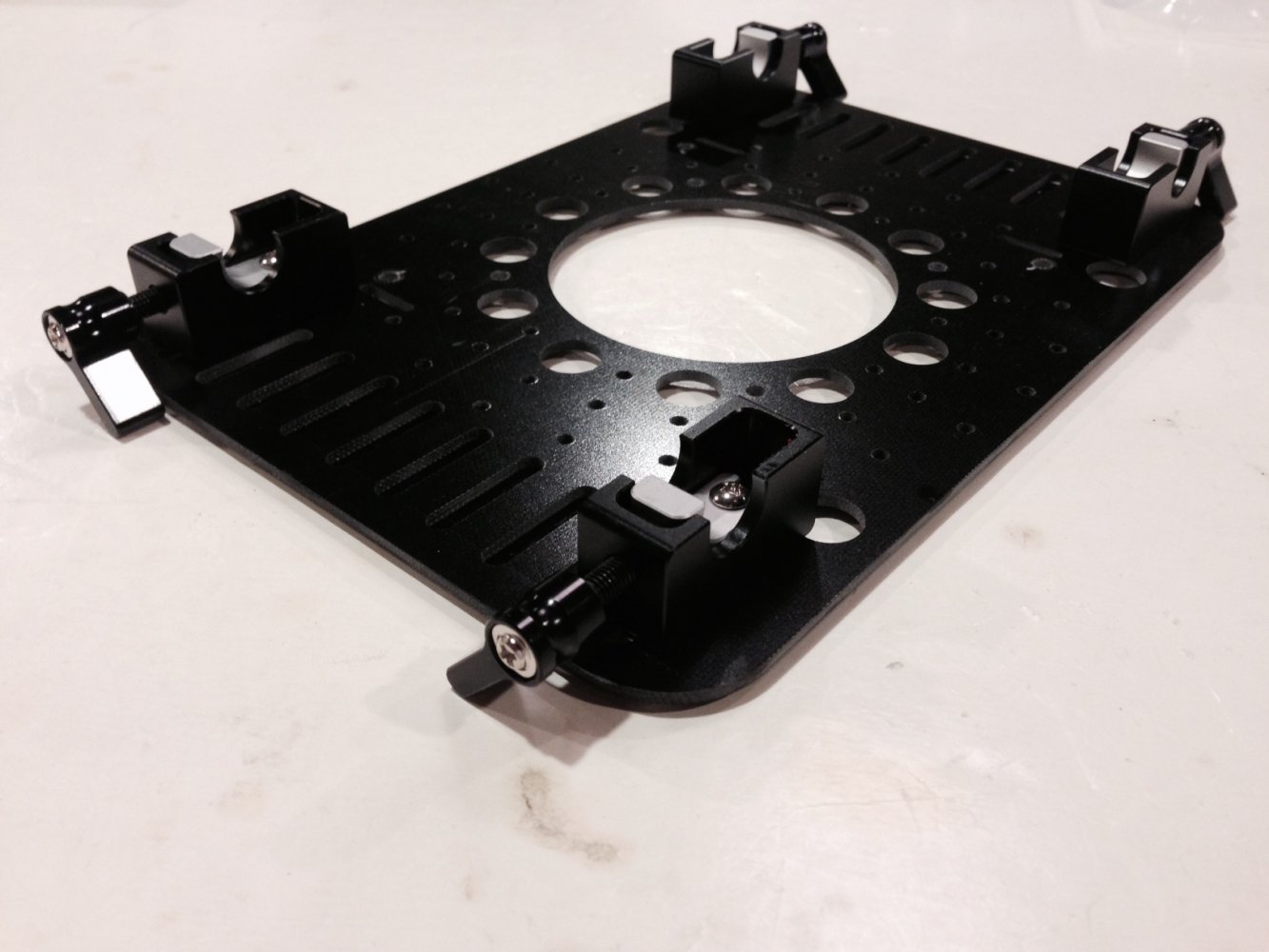

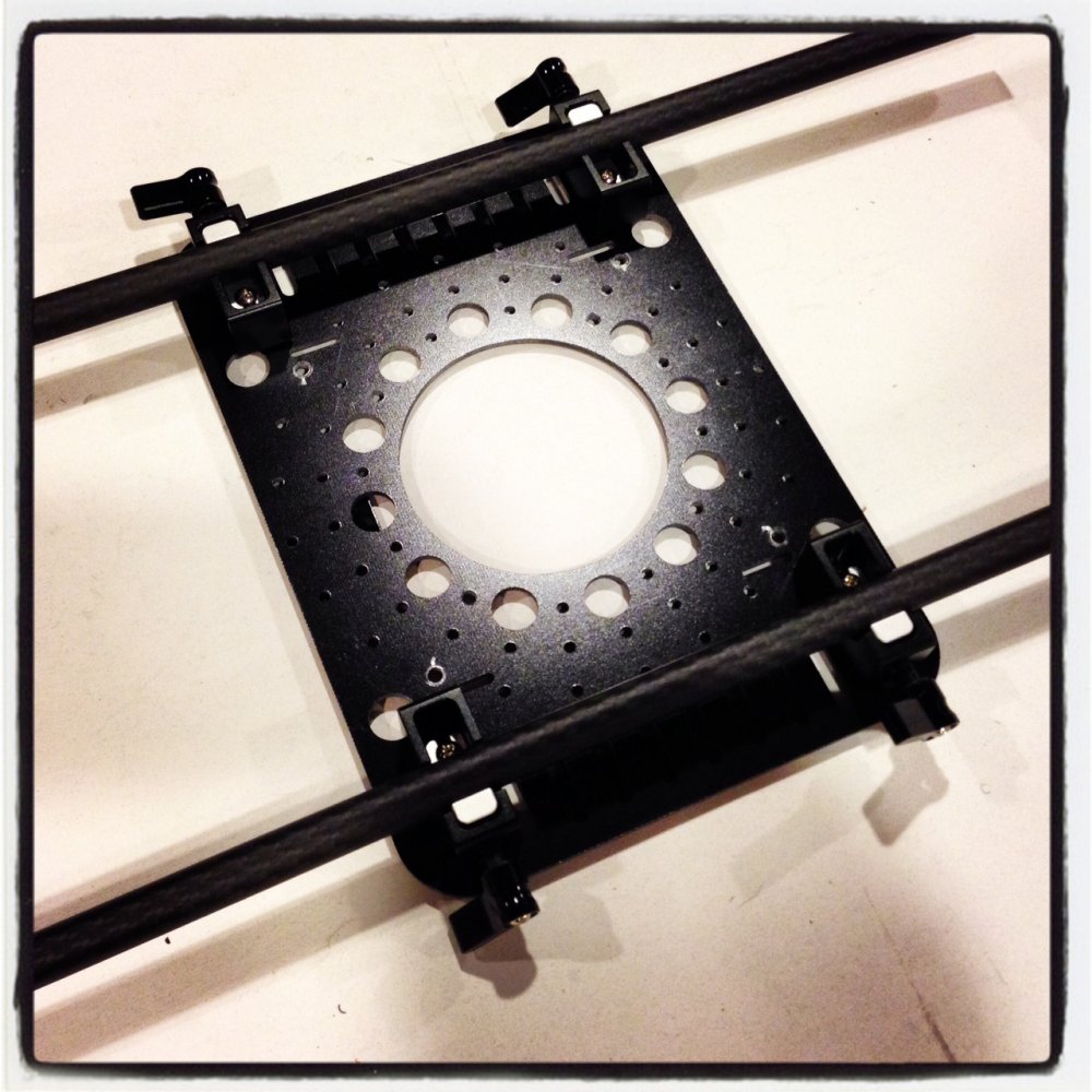

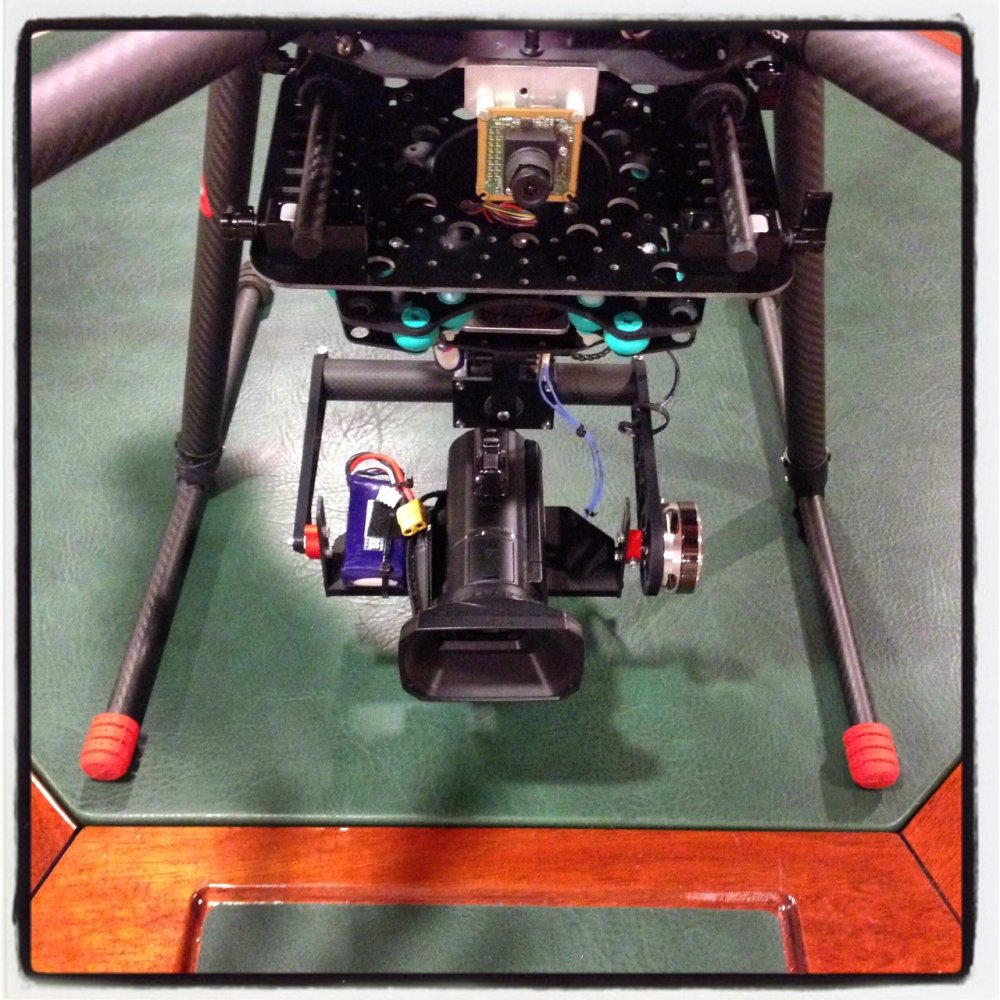

They should work just fine, I use them on a gimbal mount I made for my Tarot X6.
Excellent thanks, good to know. I noticed you are using a similar video camera. What are you using to get an fpv view from that camera? I have a sony cx-130 it has a mini HDMI out but I need to convert that to something I can feed into a video tx. Is there a cable you found that works well for that? Also to control that video camera (start/stop/ zoom) are you using something like the camRemote or rc-shutter controls?
Well if there's one great thing about this forum it's the sharing of what people are using. I have been looking for those rail clamps and now I have found them. Thanks!

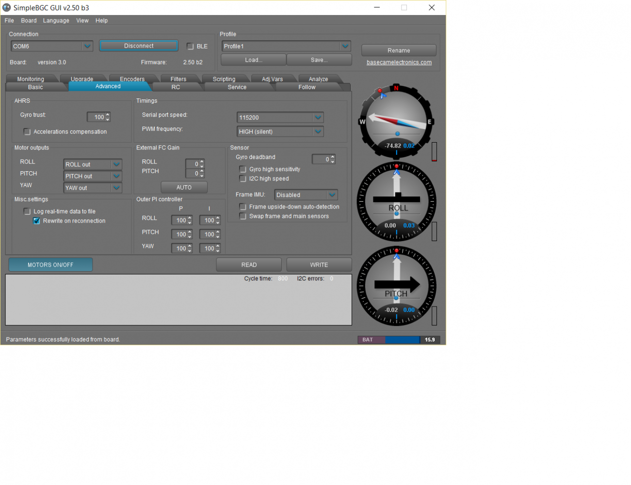

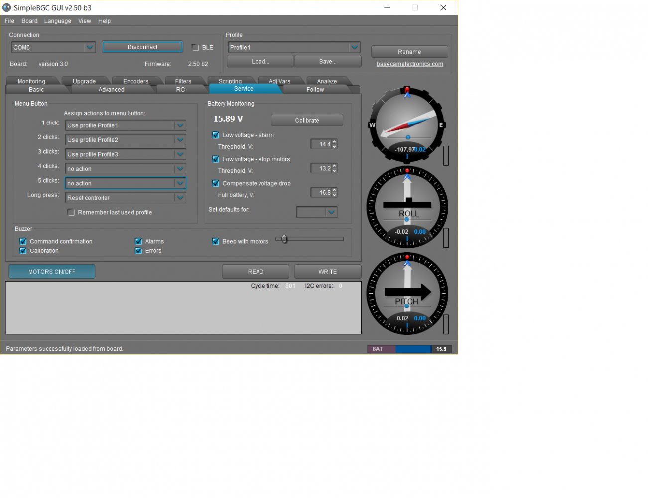

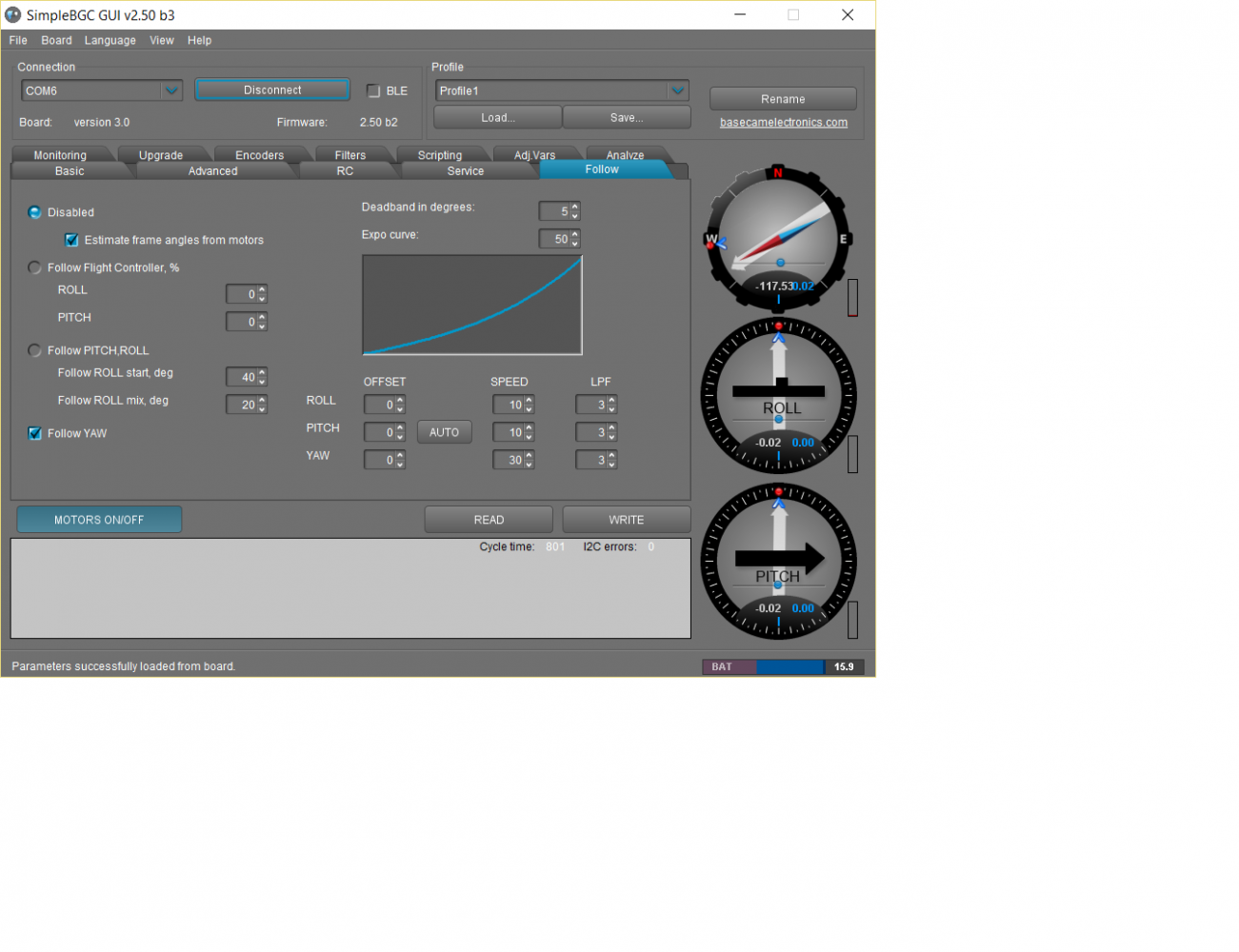

@oschefer - Yes please. The profiles as loaded on the board now. Should be able to access them through the SimpleBGC software.
And you'll be fine with those clamps. I too use the same exact ones to swap between platforms. Not as trick as a toad in the hole attachment. But for this style of gimbal mount, no issues at all.

@Filthy - here are screen shots of the settings. Are these what you were looking for? Only thing I chanced was to uncheck the follow yaw.

Yup. Perfect. I'll have a closer look once I'm sitting with mine plugged in for comparison . Mahalos!
