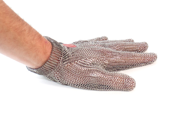

DucktileMedia
JZSlenker
Yeah, I can blow that up.
Ouch, I hope you heal quickly. I think at some point you should try to take some pictures and post them. I think it's important. Some people actually want HF to remove the new beeping while armed feature. :upset: Safety should always be our first concern. The pictures might convince others to be as careful as possible.
