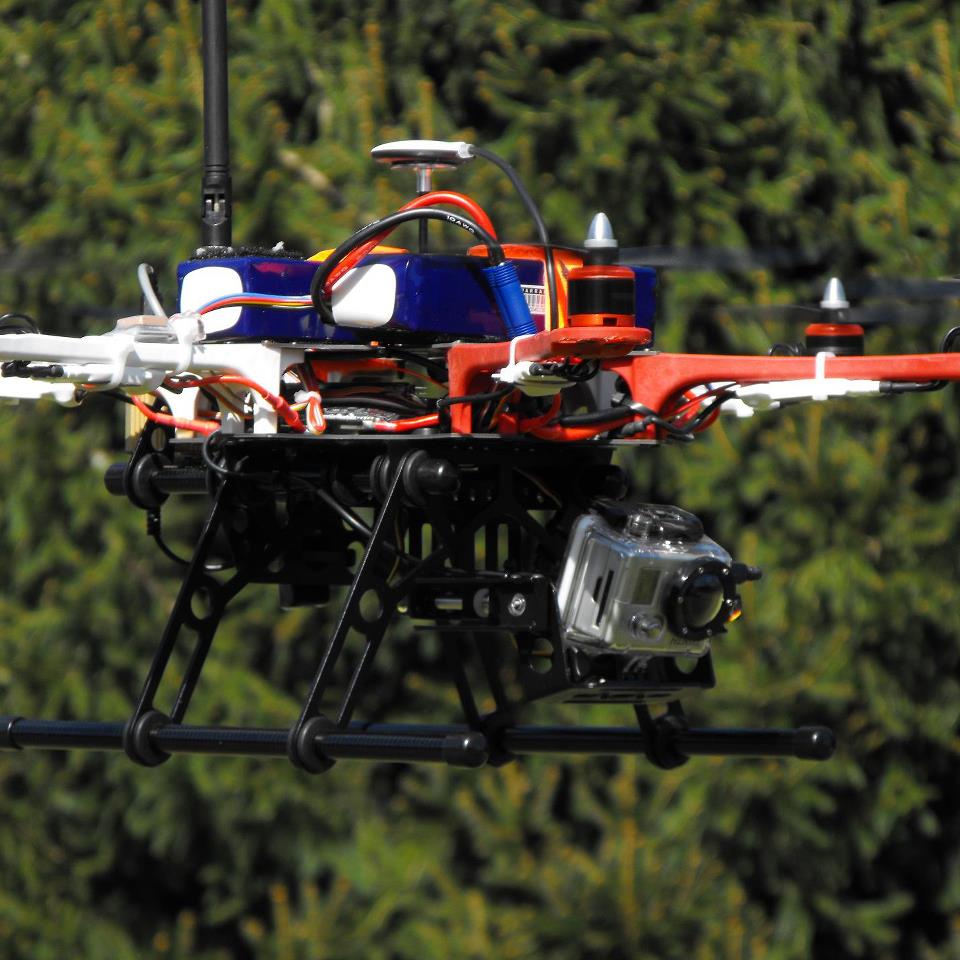

I have a Flame Wheel 550 with the NAZA+GPS, camera gimbal with GoPro, and 910 MHz video tx. Have about 20 good flights into it and it has been working great. After one crash caused by a battery coming loose, it has been acting up. The worst problem is going into reverse and slight right at high speed along with other gyrations. I've seen several posts/videos of similar behavior, called "lockover", I think. Here is a video of my most recent crash.
My speculation is that the prior crashes have the props out of balance and vibration is confusing the gyros. The strange thing here is that during the ballistic gyrations of the hex, the camera gimbal was able to stay relatively level. That leads me to belive that the gyros were ok. Possibly an ESC or motor going bad? If an ESC or motor failed, wouldn't the torque of the opposing motor cause it to spin instead of just reversing? During the flight it did stabilize for a few seconds before going for it's final backwards dive into the forest. Any suggestions would be appreciated?

Dave, because of the length of the video, I would rule out Props and Vibration. I would look to the connectors between the motors and the escs. As you use them, they heat up and may fail. You had another period of instability before you eventually crashed. Just my observations.

feel each motor/esc/set of bullets after a flight and note whats warmer than the next. when you get the cg off a hovering MR like you have pictured with the cam and gimble out front and no counter weight, your loading up the front half more than the rear half....... if you hover 500 watts, instead of each motor using 83 watts, just for example the fronts run 150, next back 90, rear 20....... and it stress's the crap out of the other set. it can be done for a while, then it eats the motors.... might feel for bad bearings. Hold the leg under a motor and spin the prop. if it's gritty, it would be one to look at for heat as well

Very good point. As I sifted through the crash site, I did notice one ESC to Batt wire had come off the solder pad, but wasn't sure if that was the cause or a result of the crash.
if it came off after the crash, it should rip the solder pad off the pcb before the wire leave the pad. it is most likely why it crashed..... make the joints nice and wet, lotsa solder and don't move while it cools
