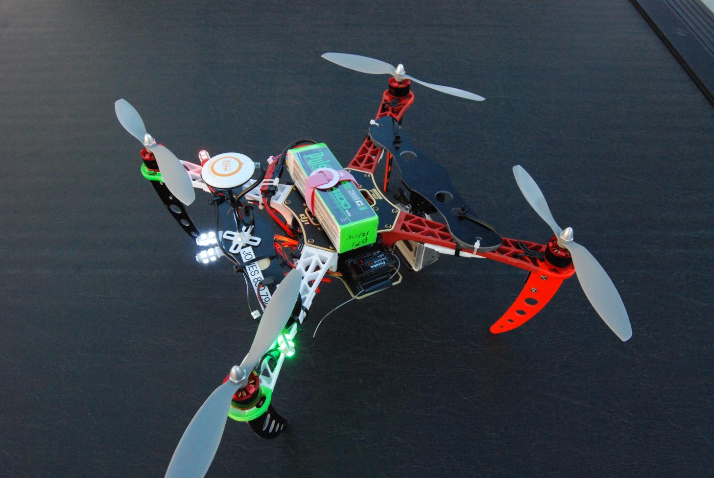

Here are some photos of my F450 at the moment.
The top plate you can see the EZOSD and the Naza IMU.
Here you can see the temp camera and the Vtx
The Rx and current sensor for the OSD
Another view of the camera and Vtx
Another view of the Rx and Current sensor.
These photos have a fair bit of temporary wiring and set ups. When I am happy with everything then I will tidy it up.
