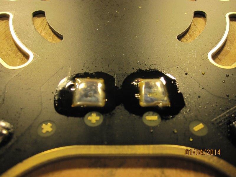

The video also shows how an ESC is soldered to the lower frame plate/PDB. It's not shown in the video but I've used the battery pads provided on the frame for just the VU and an accessory power tap (two wires with a plug for future use if necessary).

I second the thanks for the tip on scraping away the paint to expose additional solder points, wish I knew that trick before I built mine but I'll use it when I add more wiring.

thanks guys but credit goes to our fellow member MombasaFlash for the trick exposing copper to make new solder pads. I liked it so much I've been doing it ever since I saw his mention of it.

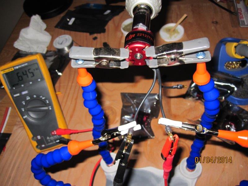

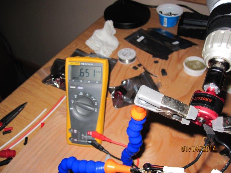

While "Base-lining" my motors I found a (what I think may be a significant difference) between some of my motors. I have 2 outliers. I have a .636 motor and a .655, where as the other 6 are right around .641 - .647 Should I be concerned about the two outliers?
Also, after watching the video you mentioned scraping off the material on the bottom for the extra power wires, I just expanded the ones on the top for my build.
Thanks for the suggestions.
Motor 1: .643
Motor 2: .641
Motor 3: .646
Motor 4: .644
Motor 5: .655
Motor 6: .647
Motor 7: .647
Motor 8: .636
So far this weekend I assembled my Zenmuse GoPro Gimbal, Landing gear/Gimbal assembly (a warning note should be included about friggin carbon fiber tubes...I mean razors!) bench checked my motors and base-lined them all, soldered the ESCs on (with shrink wrap/sleeve treatment). I'm holding off on the motors until I get my dynamic balancing equipment in and bench-balance them. I'm expecting to remove all the DJI stickers from the motors if they are unbalanced from the factory (As I've seen on videos). Tonight/tomorrow I'll static balance the stock DJI props to learn with, and just purchased some Graupner E-Prop 10x5's once I've beaten this thing into the ground a time or few.
Come on Hobby King, get me my GOODS!!!
Corey

Corey what exactly are you doing here, spinning motors with drill and measuring the voltage they make?
I've never seen anything about this (or I missed it).
