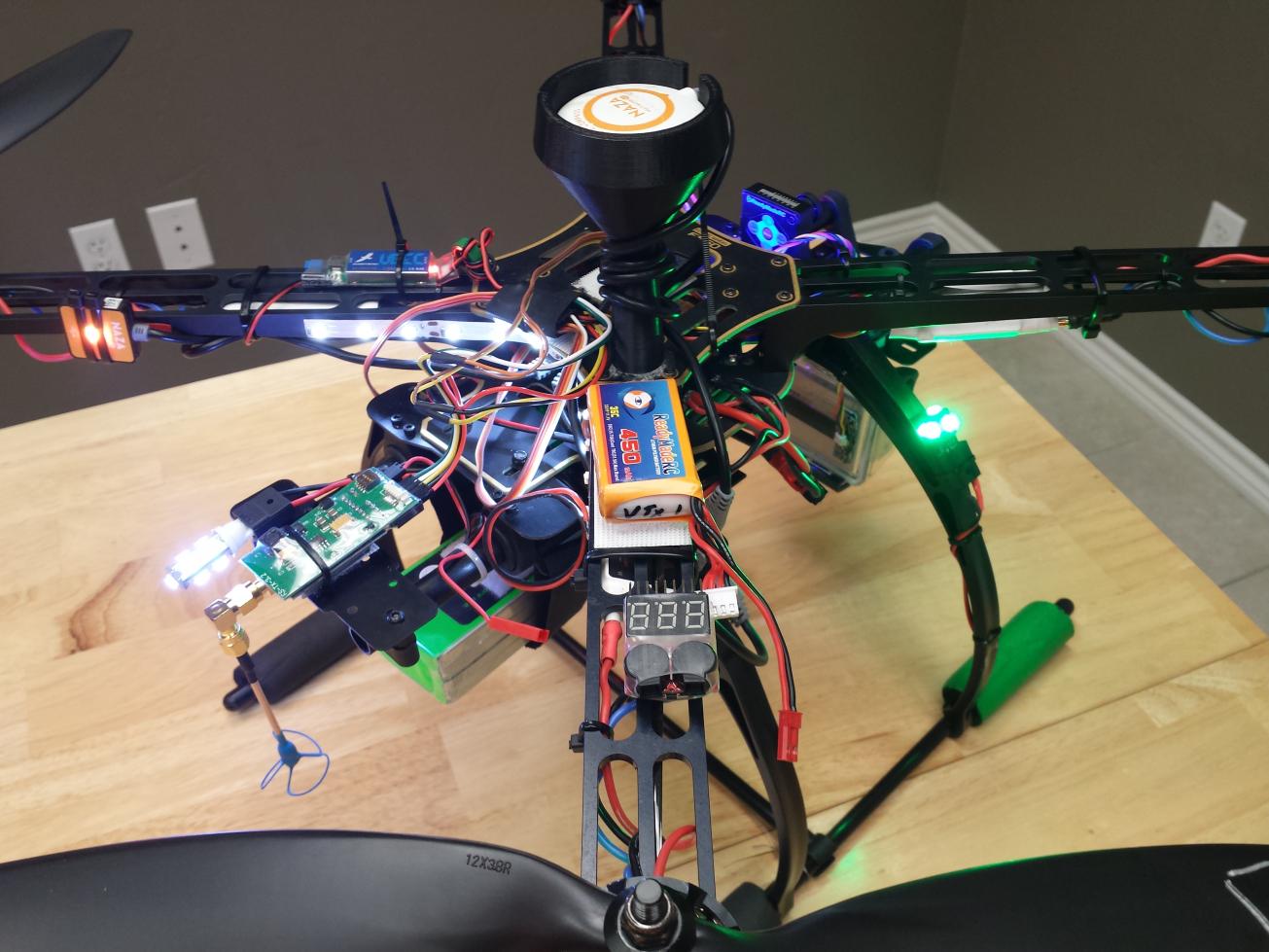

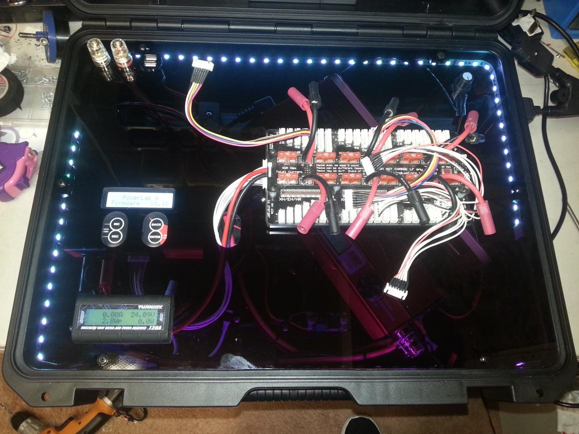

I've got a new build that had its first flight on Sunday... Built slowly over the past few weeks, following this thread mostly.
My system includes:
DJI F450 Frame with DJI Landing Gear
DJI 2212 Motors
DJI 30A Opto ESC
DJI Stock 1038 props
DJI Naza-M Lite w/GPS
Turnigy 3S 5000mah Lipo
Spektrum DX7 2.4Ghz DSM2 Air version with OrangeRx R710 & R100 Satellite Rx
FatShark Teleporter V3 5.8Ghz FPV System with stock antennas
GoPro Hero 2
Turnigy High Density LED strips, 1m of white, 1m of blue,
DIY mount for FPV cam and GoPro
I have flown it 3 times... Fully Loaded, but only LOS, the GF got to use the goggles though, haha. Last flight was 9min long and consumed 3000mah. I haven't weighed it yet as I don't have a suitable scale. Used recommended gain settings. I haven't balanced my props yet, or uploaded any video, but upon reviewing the gopro footage jello wasn't very noticeable at all, which was surprising considering it's basically just bolted to the frame.
I wanted a case that could hold everything fully assembled, and keep it relatively safe, but didn't need pelican protection or prices. I found a plastic case at WM, Sterilite 31"Lx17"WX14"H for $22... Just need to get some foam and or bungee's to secure things. it'll have enough room for all my gear (fully assembled heli, tx, fpv goggles, batteries)
Here are some pics... once I get some decent video I'll share it. definitely need to modify the LED's for night flying so they don't cause problems with the camera!

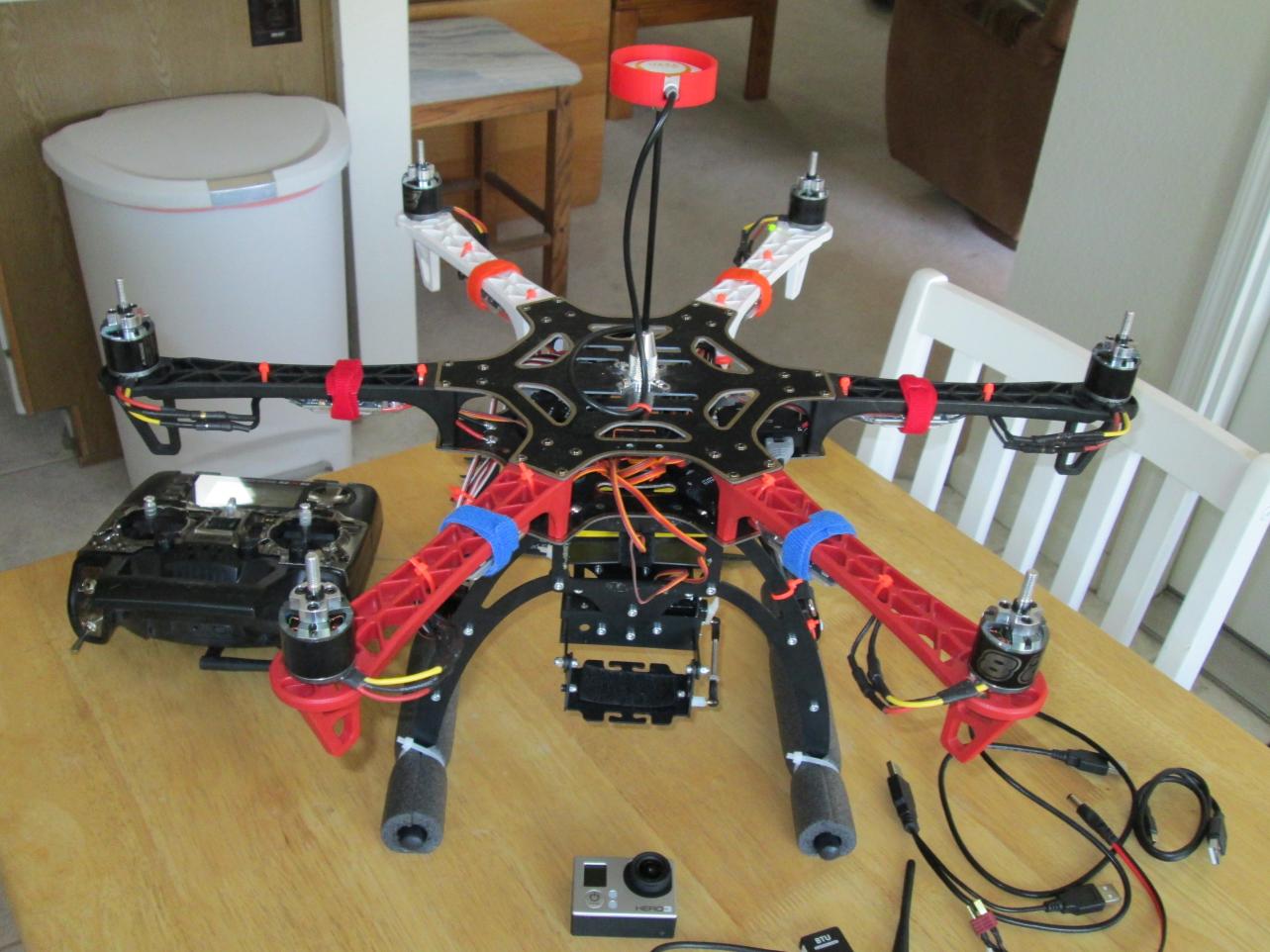

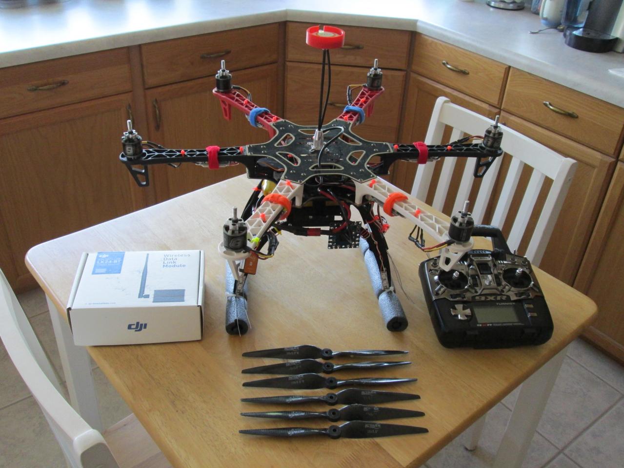

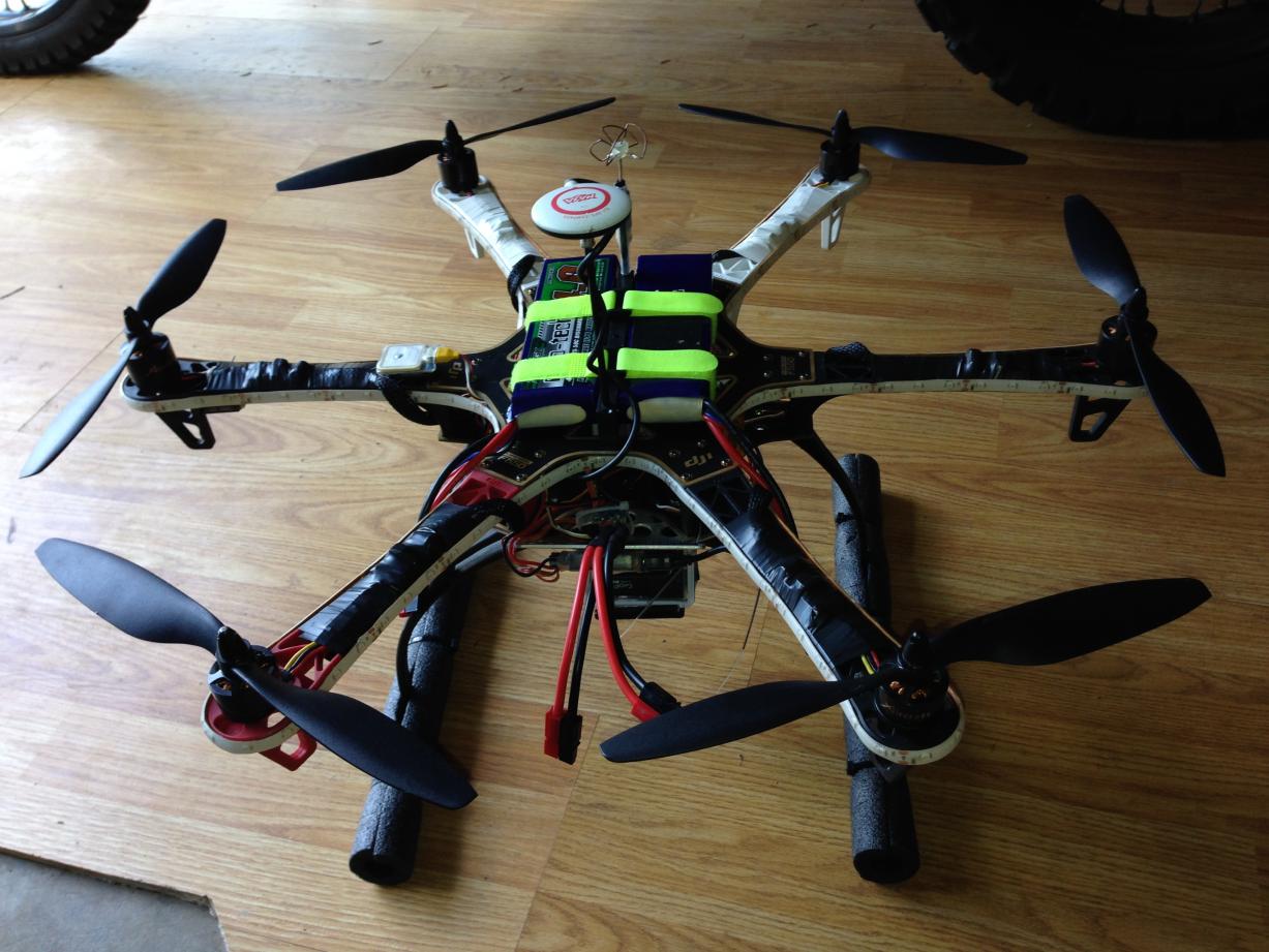

OK I'll jump in - I have been following the thread and did post a couple of questions regarding the Hobbyking frames verses DJI, in any case I have been doing research since Jan and finally settled on the F550 primarily because of what I have learned from this thread. So next issue was do I do the full kit up or get one of the F550 RTF's? I happened to be sorta trolling on eBay and what do I find but a recently built, never flown, F550 with most of what I wanted and I purchased it from a guy in Washington. Here is what I got:
- F550 DJI
- NAZA M V2, w/GPS
- Compass Tilt Stand
- iOSD, DJI
- CANBuss
- NTM Propdrive 28 - 800KV motors
- 30A, Blue Ice ESC's
- RCTimer 10.5" Carbon Fiber Props
- 9XR w/FrSKY ACCST
- iPad Flight Control system 2.4G
- Legs and 2 Axis Gimbal
- GoPro 3
- 3S, 4500 Zippy
View attachment 17417View attachment 17419View attachment 17420View attachment 17421View attachment 17422
So I checked everything out got the latest Flight Assistant and I have a question. I'm seeing recommended gain settings in the DJI NAZA manual for like 140 to 170, while the default sets them from 100 to 125. I assumed when you set the hex configuration that the defaults settings for the gains would change accordingly but I'm not sure? What would everyone recommend for the F550 gain settings?

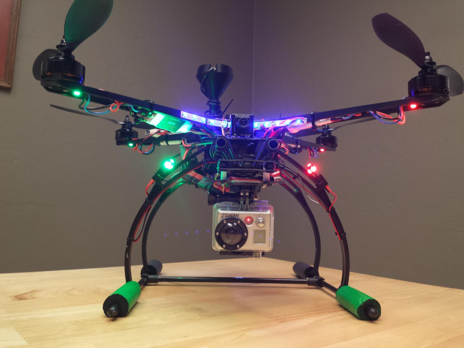

Thanks to Bart and all on this thread I successfully built a F450. I have about 60 flights on it. But that wasn't enough. Now:
(originally written for Facebook so some explanations not needed here)
It now has longer arms, bigger motors, runs bigger props, has a GoPro Hero 2 for photography, and I've just added a "pilot cam" and video transmitter which send video back to me to view on a 10" LCD monitor. I can switch between what the pilot cam sees (it's a view as if you are "in" the quadcopter) and what the GoPro is filming. Two nights ago I added and On Screen Display (OSD) which superimposes data on the video screen such as speed, height above takeoff point, direction back to home, battery voltage (i.e. how soon is it coming down!), and more. A package is enroute with a gimbal so I can tilt the camera up and down and compensate for roll to give a steadier image.
For those interested technically, it is:
DJI F450 frame
DJI NAZA-M V2 flight control system with GPS
Amdroix extended (by 50mm each) aluminum arms
SunnySky 3508-16 700KV motors
Props range from 10-12 inch - shown with 12x3.8 pitch
Video package from ReadyMadeRC, LLC with the 5.8Ghz system, pro700 camera, Fatshark 250mw transmitter w/ independent 450 mAh battery, UNO5800 receiver with 1350mAh battery for it and the LCD monitor
DJI iOSD mini on screen display
ATG generic landing skids
Lots of LEDs Jennifer Jones says too much
12 volt BEC (dc to dc converter) for lights
5 volt BEC for cameras
Gimbal is the Beholder by Team Rebel Design
AUW before the gimbal is 2300 grams. That will put it at 2600.
The transmitter is a Futaba 8FG Super with 14 channels and Futaba receiver. Mounted on that now is the 10" LCD monitor for the First Person View (FPV) flying. I have not yet been brave enough to fly solely FPV.
Some say it's lunacy. Who am I to argue....
My website at www.captainjustice.net will eventually have all the details and links to sources.
I use a couple of batteries (times are pre-gimbal):
Pulse 4100mAh - 10 minutes
Pulse 4500mAh - 12 minutes
Gensace 5500mAh - have not tested on this configuration yet.
The Video Receiver & monitor has a RMRC 1350mAh battery - no idea yet how long it will last - should be 10+ flights
Video transmitter has its own RMRC 450mAh battery
View attachment 17522 View attachment 17523 Pardon the wiring mess. Have not had a chance to dress that yet. I did a range test and brief maiden flight today with the FPV gear and it is awesome! Wind was 12kts and gusty so I did not dally.
