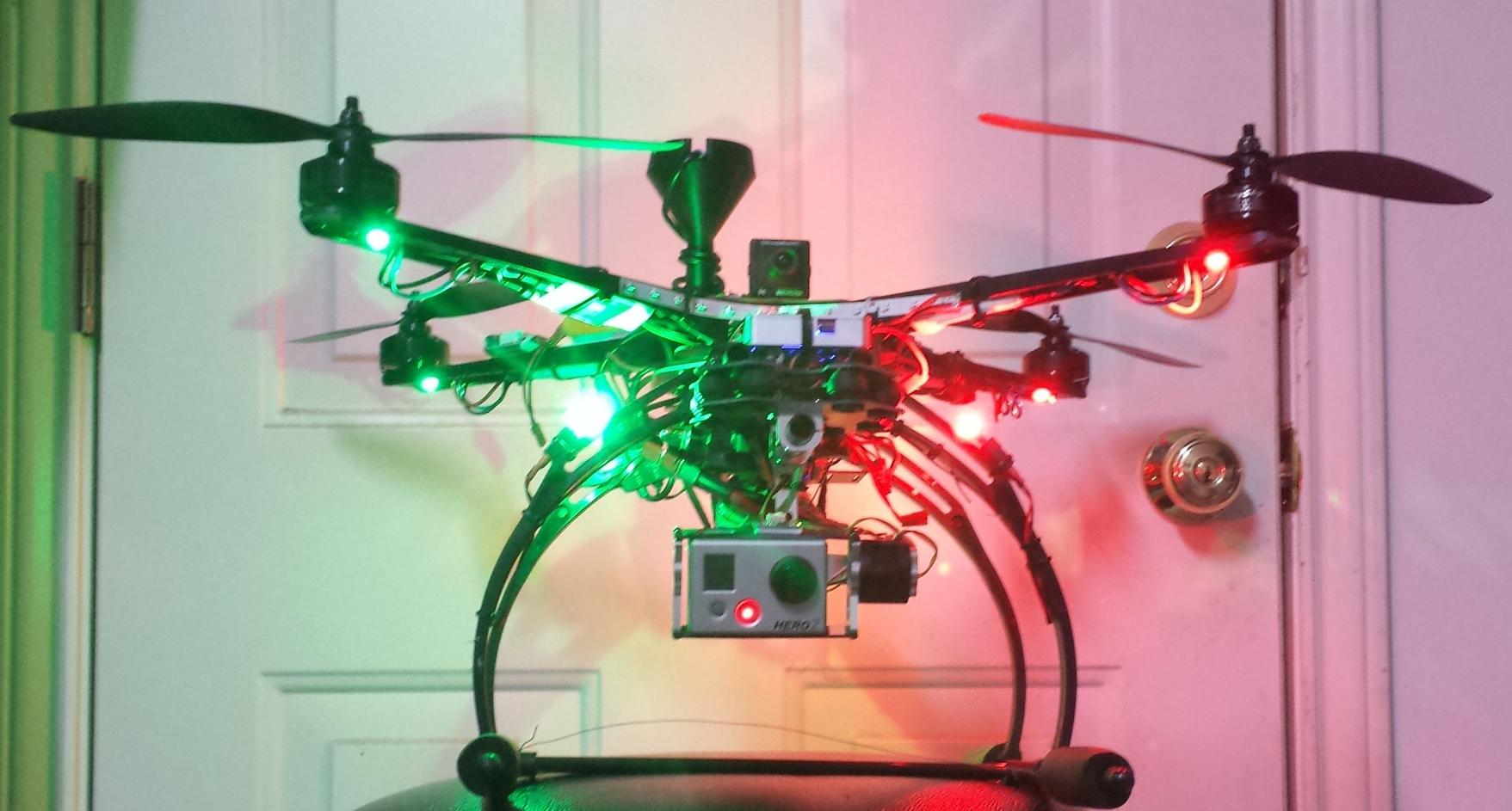

JoeBob
Elevation via Flatulation
Captain J: 'Tiny bit of movement' = it moves if you push against it. Flight seems stable, but I am no expert. Too little experience.
http://vimeo.com/91877939
(Yep - I need to slow down the Gimbal pitch speed and yaw. It was windy as heck!)
I have considered adding some soft rubber to the bottom of the top plate to push down on the FC to dampen any vibrations, but I don't know about heat build-up.
