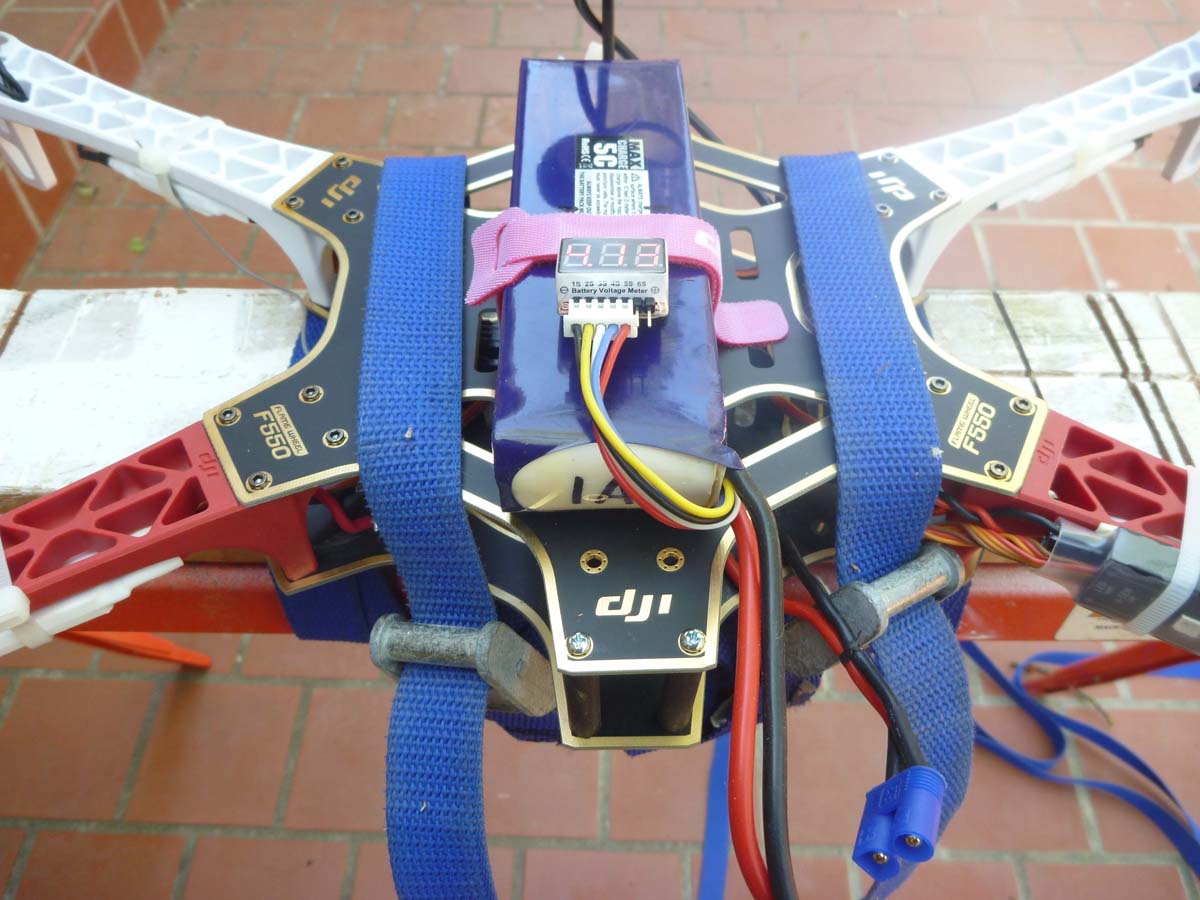

Success!!!
Happy to report that I had a successful first flight today of my F550 Quad, thanks to this forum and specifically, this thread and especially Bart!:highly_amused:
My build ended up consisting of:
F550 frame (using only four arms)
Naza Lite flight controller
Turnigy Nano-tech 4-cell 4000 mah
Tiger 2216-12 motors
DJI 30amp ESCs
8” APC props
Futaba 14sg radio
I ran thru two batteries with about 9 – 10 min. flights, and everything worked, including a decent GPS position hold. I followed Bart’s advice and did not program any fail safe or IOC yet.
I’ll post some pics, as soon as I figure out how – the uploading circle spins forever , even with small jpegs……
But anyways, thanks again to all!

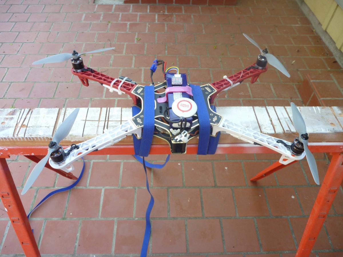

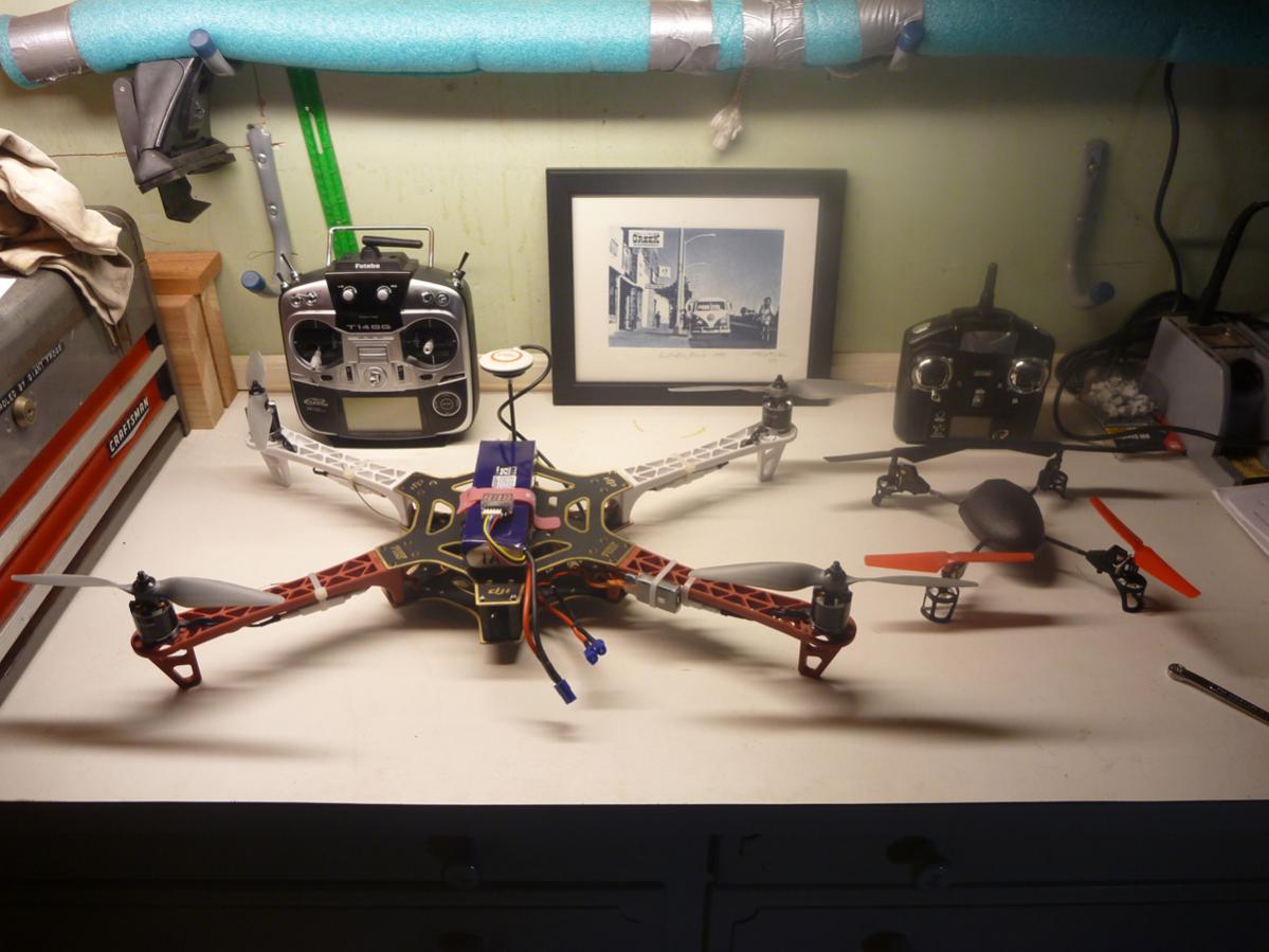

Dezy
