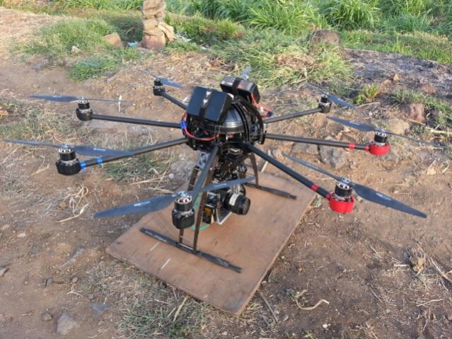

Had my maiden flight today with the Movi on a Skyjib Super 6 with 16.x5 wooden Xoars.
It went pretty well, however after the flight I felt the motors, and 3 of them were pretty hot 1,3 and 5 basically all the anti-clockwise ones.
I also had a bit of a toilet bowl effect spinning CCW, usually this thing stays put.
I know my gains need a lot of tuning, but would this cause the CCW motors to get hot?
They were not too hot to hold, but still quite hot to what I have seen before.
The ESCs were not hot at all, so what can cause CCW motors only to be hot, could it be the gains not being correct, or a different kind of problem?
Flight was just over 10 mins.

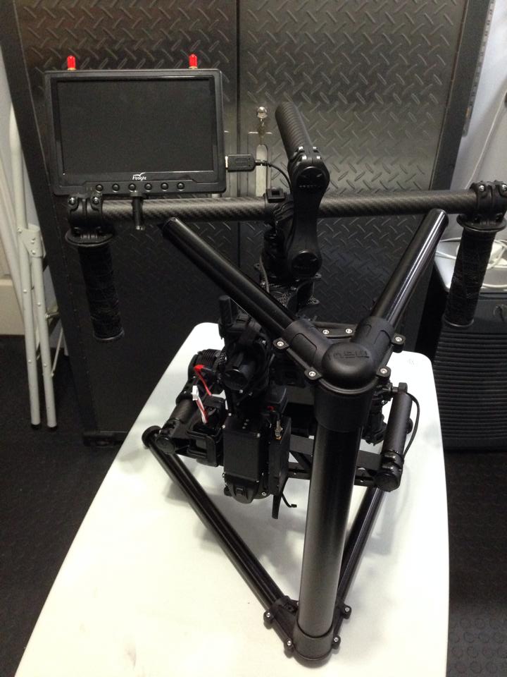

M5 arrived. Amazing. I had the GH3 on it and balanced in running in probably 15-20 mins out of the box. I'm sure it can be balanced a bit better and tuning dialed in but it's the best balancing experience i've had with a gimbal. So much easier than the cheap Chinese gimbals and Alexmos.
econfly
Isn't it great when a product works and is well engineered? Their dual-rail approach with those quick-adjust brackets make just about everything else look stupid by comparison. When you can get almost perfectly balanced in minutes, and adjust settings with a phone/tablet so quickly, the result is a real pleasure to use.
flitelab
Yes very impressed with the out of box experience so far. no doubt will take tweaking to get perfect but I think I spent 2 days on a Chinese hand held gimbal before and still wasn't half as good as this out of the box after tuning and balancing many times.
