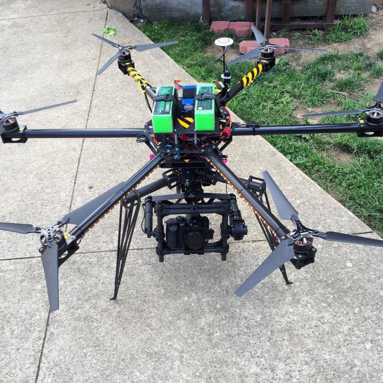

I LOVE my M5. The only problem is that you will want 2! One to stay handheld and one to keep on your rig!
