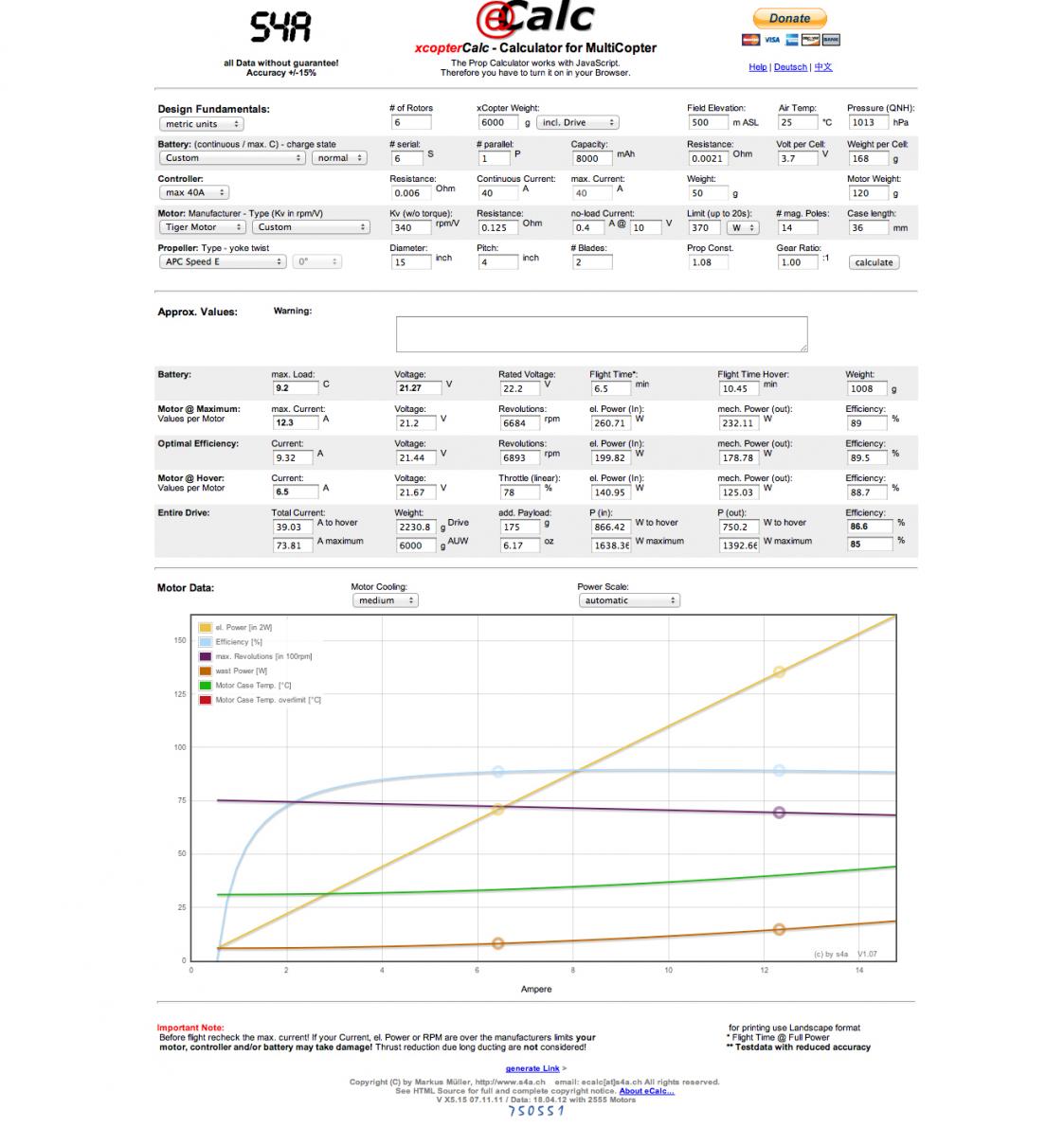

can anyone speculate the amp draw at hover? 6S lipo and 340KV motor, I would say 7-8 amp for each motors at hover, make it less than 50amp, dont think anyone will do sport-flying with your S800.
Geoff
can you tell us the amp draw?
BorisS
roughly speculating here, just this could be about right. I don't know the pitch on the props the final weight etc.
But 6s low KV motors the A will be pretty low so all of the C rated lips from above should work.
quadcopters
Geoff
The motors are 320kv I would say to be honest very little indeed with a 6s Lipo , I have not had time to measure AMP Draw yet but guessing will be about 6 - 7 amp per motor with 10000mah 6s and probably rising to about 9a with gimbal and camera .
These are only guess figures but they will be very low current draw.
Geoff
