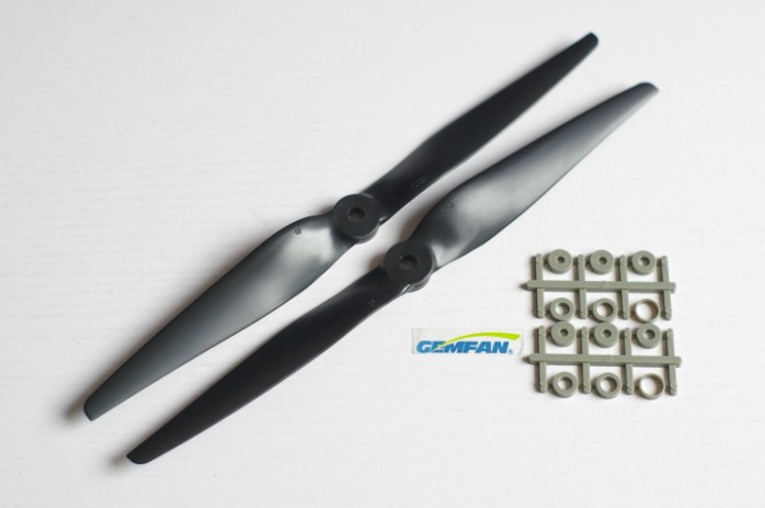

I'm running the Gemfan copies of the Graupners now, very nice so far! (and cheap) Checkout those hubs..
