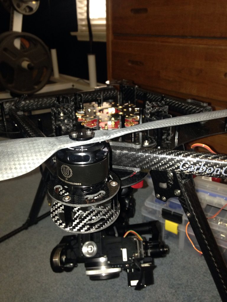

MrTarango, thanks for the link. I'm going to try a set of those. I might also machine some sort of insert that I can slip into the leg so I can possibly cut them in half and have a quick release of some sorts so the long landing gears can be "shortened" for transport (to fit in a case).
I think putting a little bit of some insulation on the cf esc plates would be a good idea. I could see that causing some problems (as Quinton has seen). Haven't seen it yet on mine, but it would be an easy preventative measure.

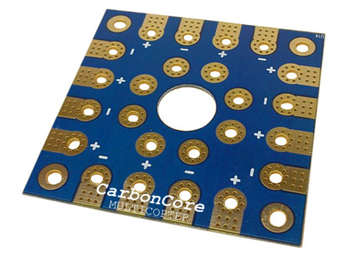

How to fit the ESCs inside the cooling holes with such a massive power board...
Mrtarango32
http://www.multirotorforums.com/showthread.php?t=17947
Maybe choose the motors for your payload (and combined Cortex and motor-battery) weight first (We copied ElectriFlite in on the email as they might be able to help)
Then multiply the max(?) motor current by 8. Max with a question mark because the flight controller will never allow full throttle as there would be no rpm left for control response to maintain stability.
The very light and cheap power boards that fit the cortex, can be stacked to multiply the current rating... Need 400 Amps? 4x £6...
But if a 7.8Kg Cortex is pulling 5.4A per motor on average... 400A at less than 100% throttle is lifting.... No prizes for most amusing answer! :friendly_wink:

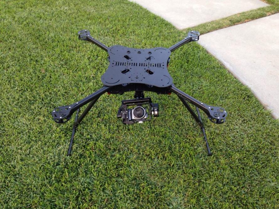

Swarf what setup do you have ?
Auw? And flight time. Looks good
Thanks. Here is my setup as of now:
CarbonCore Cortex aRTF
DJI A2
DJI Zenmuse Z15n Zenmuse with NEX7 (and 20mm lens)
DJI IOSD Mk2
Iftron 500mw 5.8ghz tx
T-motor 15x5 (top) and 16x5.4 (bottom)
Swapped out ESC's to T-Motor t40a 400Hz
(2) Turnigy Nano-tech 8,000mah 6s
DX8 for Cortex, DX7 for Zenmuse
I haven't checked the weight yet. Also haven't had a chance to check full runtime as it's been either really cold or really windy. Come on spring!!!
