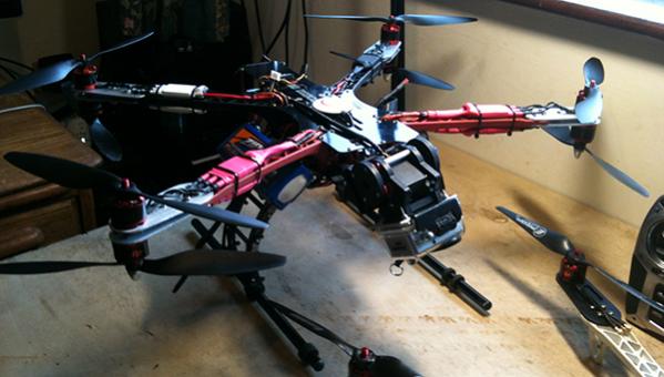

I am in the middle of building a naza gps discovery x8 and a flat naza gps octo pic of my build so far below:-
I saw a you tube video of a guy testing a x8 while connected to a mains supply and a short training stand, so he could test all controls for an hour without continually changing batteries.
My question to you and fellow enthusiasts is do you or anyone else know how to do this?
Thanks for any suggestions (including what forum i should really be asking this question in if its the wrong one.)

We can't tell you what PS you would need. You'll want either 12V or 16V depending on whether you fly 3S or 4S and it needs to supply enough current to hover your machine. You would measure this with a watt meter or guess high from motor/prop charts. Here are some to choose from.
