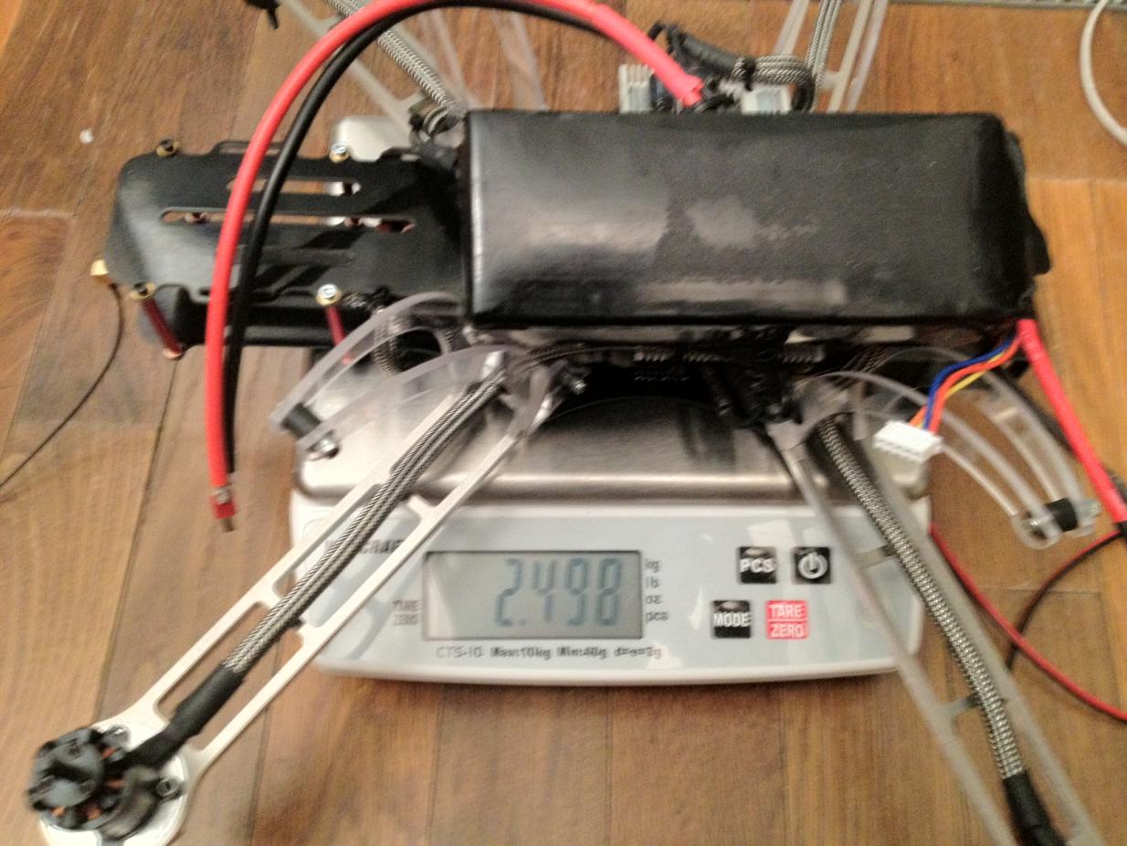

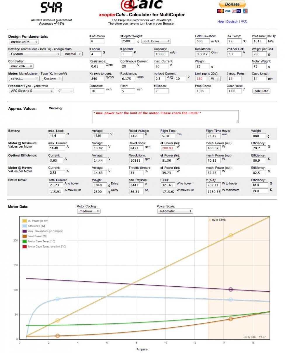

Its more for fun ;). Put a 10000 mah lipo on it and see who long it goes. Pop it into manual and see how fast the rise is and speed it can pick up etc.
I will maiden it like this this coming weekend, but i am already thinking about changing the center plate and cutting something a couple cm more spacious and shifting the COG a little.
