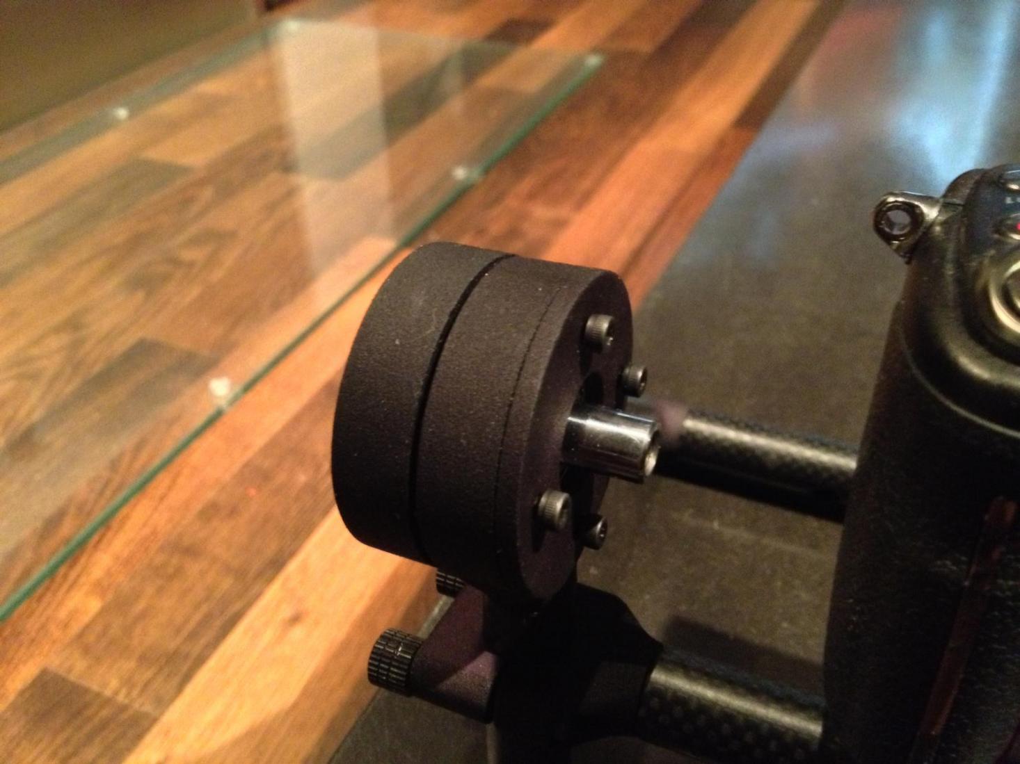

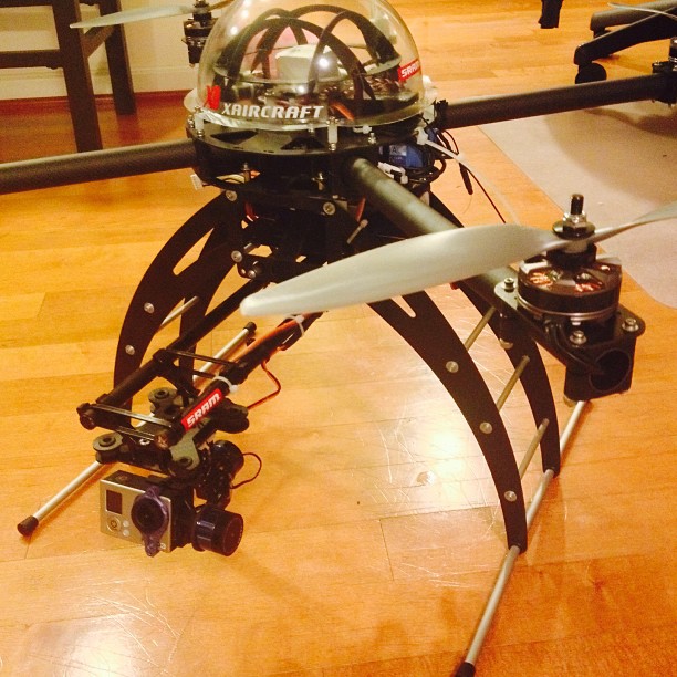

BorisS
gopro version i am happy with. Little wag on the tail either the yaw of the bird or the vibration isolation still have to figure it:
DSLR mount is coming along. Still on the roll axis had 4 different versions already wasnt happy with them all.
But pitch is finished more or less:
View attachment 11465View attachment 11466
Ill try a 5d this weekend and see if the pitch motors makes it ! The roll motor shouldnt have any problems the one i planned

Wow Boris thats looking very good. love the adjustability!! Fingers and toes crossed your design works!! Nice dip in the pool btw ;)
