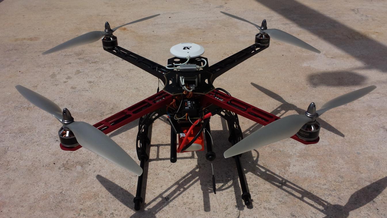

My setup is a DJI F550 with these Aluminum arms, my AUW WITHOUT battery but including the H3-2D Zenmuse + GoPro is 2.174kg's. I run 2x 4S 4200mah batteries usually in parallel and they are about 400g each. I get around 10min flight time. My motors are the 770KV Aerial media Pro heavy lift 2814's with 11x5 carbon props. I find this setup very stable and handles winds with ease. Motors and batteries are barely warm to touch after each flight.
Jaybeast
Hi Jaybeast
Hey Above,
Thanks for your reply.
Couple of follow-up questions if you don't mind sharing... Since you didn't mention otherwise, I'm guessing you're using the stock DJI ESCs, correct?
Have you tried using 12" props? If so, what was your experience? Plugging in your info to eCalc, it says you'd eek out a bit more flight time with 12x5 props. Of course, real world experience is different :)
Are you using the new AMP motors (V2 as they're calling the heavy lift kit) or the Avroto motors. How are you mounting them to the aluminum arms? Readymade says the arms can accommodate 16mm to 25mm motor mounting holes.
Thanks again for your info :)
J.
"I'm guessing you're using the stock DJI ESCs, correct?" - Yes the 30AMP DJI ESC, had no issue todate except one of my bullet connectors managed to come loose, not really and ESC issue.
The Motors are these ones http://aerialmediapros.com/store/motors-esc-s/307-amp-2814-heavy-lift-motor.html I think they do have another version out. I know other manufactures have similar ones now available. I have had these for about a year now.... technology is always improving
Have you tried using 12" props? " - I have considered giving some 12" props a try as you mentioned i should get some performance increase. I have not done this yet as I have not found a local supplier who stocks them and was waiting till I need other parts / equipment rather than just ordering a set of props. Living in Australia means we pay through the @55 for freight etc. I have mentioned this to one of our local suppliers and they indicated they will try to get some in.
My belief is to gain more flight time I would really need to move up to a bigger frame and much lower KV motors and 15" props. Something like and S800evo. This would be a considerable outlay new batteries etc etc. So i'm content with my setup for now at least. I know of others who have larger setups and can at least play with theirs :).
Good luck with it, they are allot of fun.
No the AMP motors bolt straight on. The arms are slightly lower in height than the stock arms which did not bother me, but you can order spacers if you need, also dont come with the little landing legs, again something you can order if needed.
One thing i did not account for was transporting it. It is rather large and although i have a large SUV it takes up allot of space, especially if going camping etc, does not leave much room for other stuff. I am thinking of either building a small quad or designing folding arms for the current build. All this takes time and money for which my wife is eternally grateful :beaten:

I just have to say how pleased I am with the aluminum arms from ReadyMade RC. They're really well made and I haven't noticed any discernible difference in the sound (some had complained about a higher pitch when the motors were at speed). I completed the install and motor upgrade yesterday and made my first test flight - very smooth flight even without modifying my gains yet. My new F550 (or 650 now) is equipped with new Cobra 2221/16 940kv motors, DJI Opto 30a ESCs pushing 12x4.5 Gemfan props (though a bit flimsy). The test flight yielded a mixed flight time of almost 8.5 minutes on a 3s 4100mah 25c lipo. Though I was missing about 800grams of my AUW (will be approx 2700 kg), i was impressed with the efficiency of the setup. After takeoff I can hover at about 45% and there's plenty of thrust. I discontinued flying at my Naza's first stage voltage warning, which is set at 11v under load, I think. After the flight, my motors and ESCs were barely warm (temp outside was 65 F) though my lipo was a bit warm... by no means hot but noticeable warmer. Am I taxing this pack?
A couple of notes if you're thinking of upgrading to these arms... First... if you're using the same ESCs that are soldered to your F550 pdb make sure your esc's fit through the opening at the end of the arm. The standard DJI Opto 30A fit with a hair of space to spare. If your ESCs are bigger, you may have to resolder your ESCs to the board or get creative with placement.
Secondly, check the length of your motor mounting screws. The motor mount area is a bit thinner than the stock 550 arms so you many need shorter screws depending on your motors.
Third, it was already stated in the thread but the aluminum arms are shorter where they mount to the 550 body. Depending on what you have sandwiched in there you may need the spacers ReadyMade sells.
Lastly, do it! These aluminum arms gave my F550 a new lease. I was ready to ditch it feeling I had outgrown it for the AP I wanted to do. I nearly spent a lot more $$ on a higher end rig but for a modest amount I've been able to increase my overall flight time and/or carrying capacity, which was my goal all along.
Thanks to all that have contributed to this thread and forum. Such a great resource!
J.
