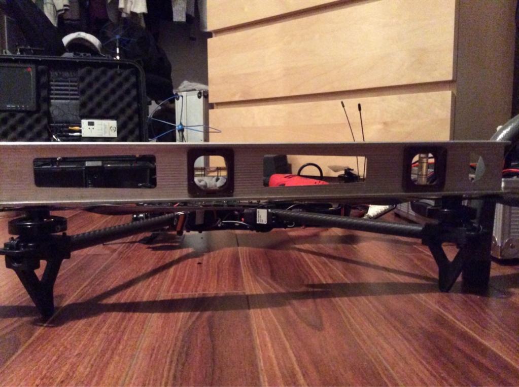

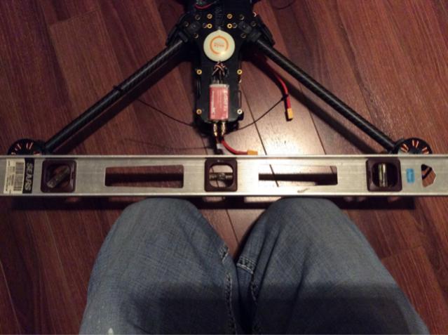

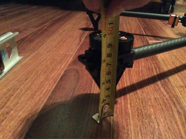

View attachment 19733 not sure what to do i have to aligne the motor with the others or to be parallel with the floor what i did is i mesured each sode of the motor like this View attachment 19734 to have the same mesure at each side...

like you got there with the bubble level is perfect, from there you gotta get what the level is sitting on flat under the level, then you turn from the back motor to the one in front of it and do it again. your trying to make the props all flat and level,,, if you have 15" props once the backs are level, you can level the fronts with prop tips.... they come close enough to show it....
I can't really see, you would be looking at a macro picture of the area the prop sits, twist the motors till that level is laying on the area flat on both sides....
Ha good its seems really flat now thanks for you help your a king i hope i can fly 20 min now... .). last question is it normal that my gimbale shut down, and my video reception glitch and close 1 secondes and restart when the vtx getting hot with no air flow ? Or it an other problem.?
