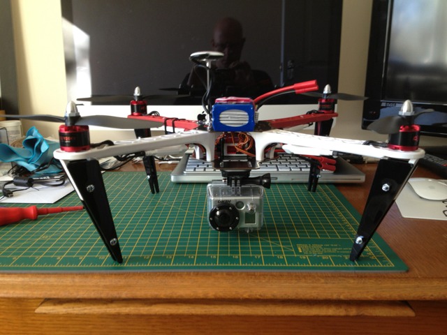

ROVguy
Kloner, the legs arrived today, so I fitted them and the go pro. There is just enough room for the go pro underneath the bottom plate. If I had known about the new hero3 I would have waited for that. I will try and get out flying today and see how it goes. Also legs are inscribed and fold back.
yikes..... this is power up the tx,,, power up the rx,,,, while it's all on, press in the bind button, right?
