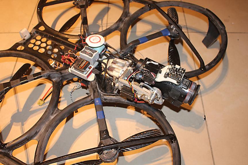

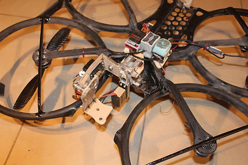

Its me again. Interesting day, Tested out my 450 Naza with Spektrum DX8 ans AR8000 this morning. Placed the satellite out on the left rear boom as suggested to rule out signal loss from the DX8 and the RX. Started the flight all seemed better, then after about 3 min I start to see an orange LED on the Naza (while in manual flight) meaning TX signal loss. Bring the 450 down and look at the satellite and AR8000 and they are still lit with no blinking light (would indicate previos signal loss). So I take it up again only about 2 feet off the ground and the orange LED on the Naza blinks faster now, still able to control it just starting to get small "glitches" in the 450 but still responding to inputs from the DX8. I then bring down to land. Right when I land the "glitching" really starts to pickup, with the motors speeding up and slowing down fast. I try to shutdown the motors at this point but no response. The 450 then speeds up and starts to try and lift off. I reach for it to unplug the battery to prevent it from flying away uncontrolled and just then almost full power bust and cuts my hands to bits. I struggle with gett the battery pulled for a few seconds (with my hands covered in blood by this time. Also tried shutting down the motors on the DX8 in this time to no use. Anyways long story short I have no idea what the problem is and this has happened on a few flights now. Any ideas? Defective parts or just me being stupid? Your thoughts would be great.

A frame grab from the onboard GoPro recording video the whole flight including when my fingers got cut to bits, resulting in 14 stitches, may post the video later on...

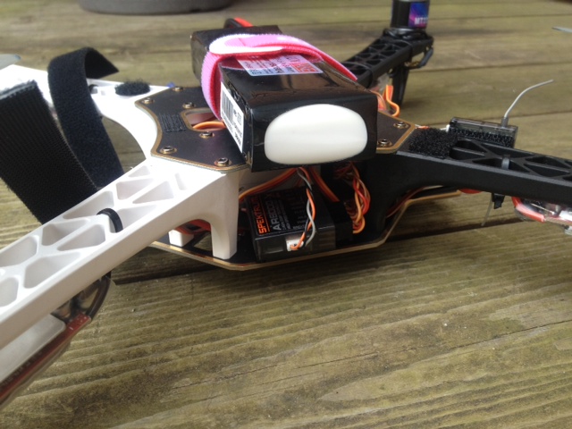

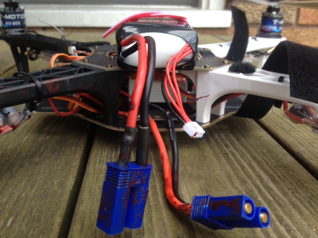

I would take the props off this thing till i could walk around the yard with it on the ground and not blink like your seeing,,,, like 3 packs in a row. something is dangerously wrong with your setup

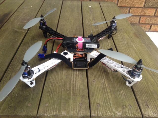

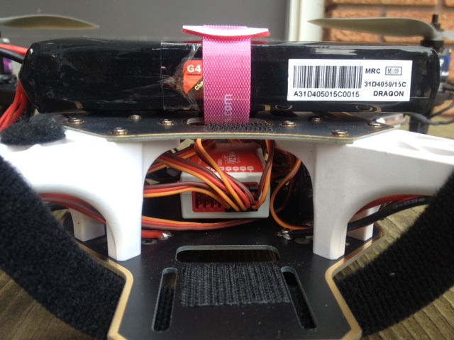

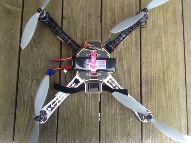

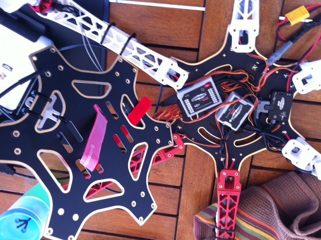

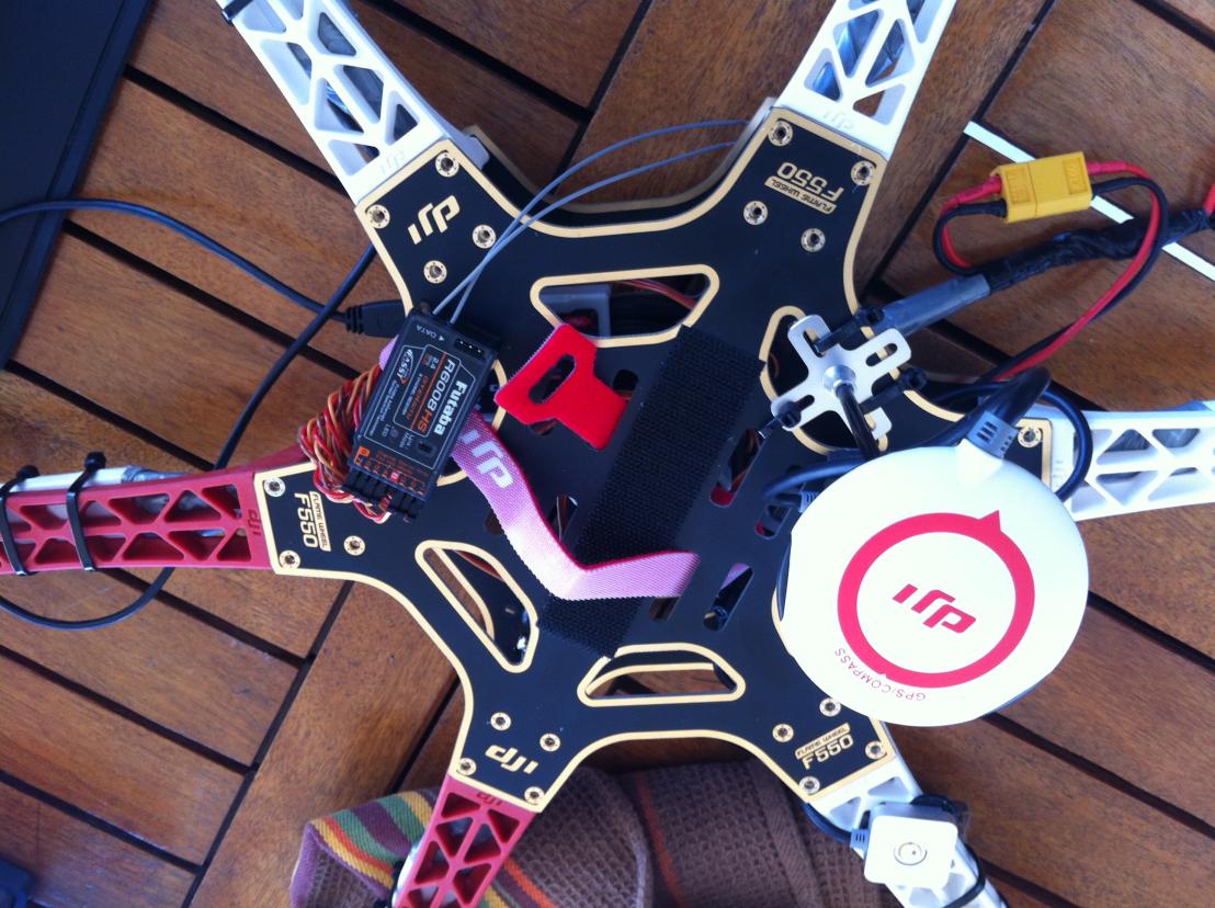

You should post pics of how everything is installed, noticed the esc's are just hanging by there wires? whats the rest look like?
leemann

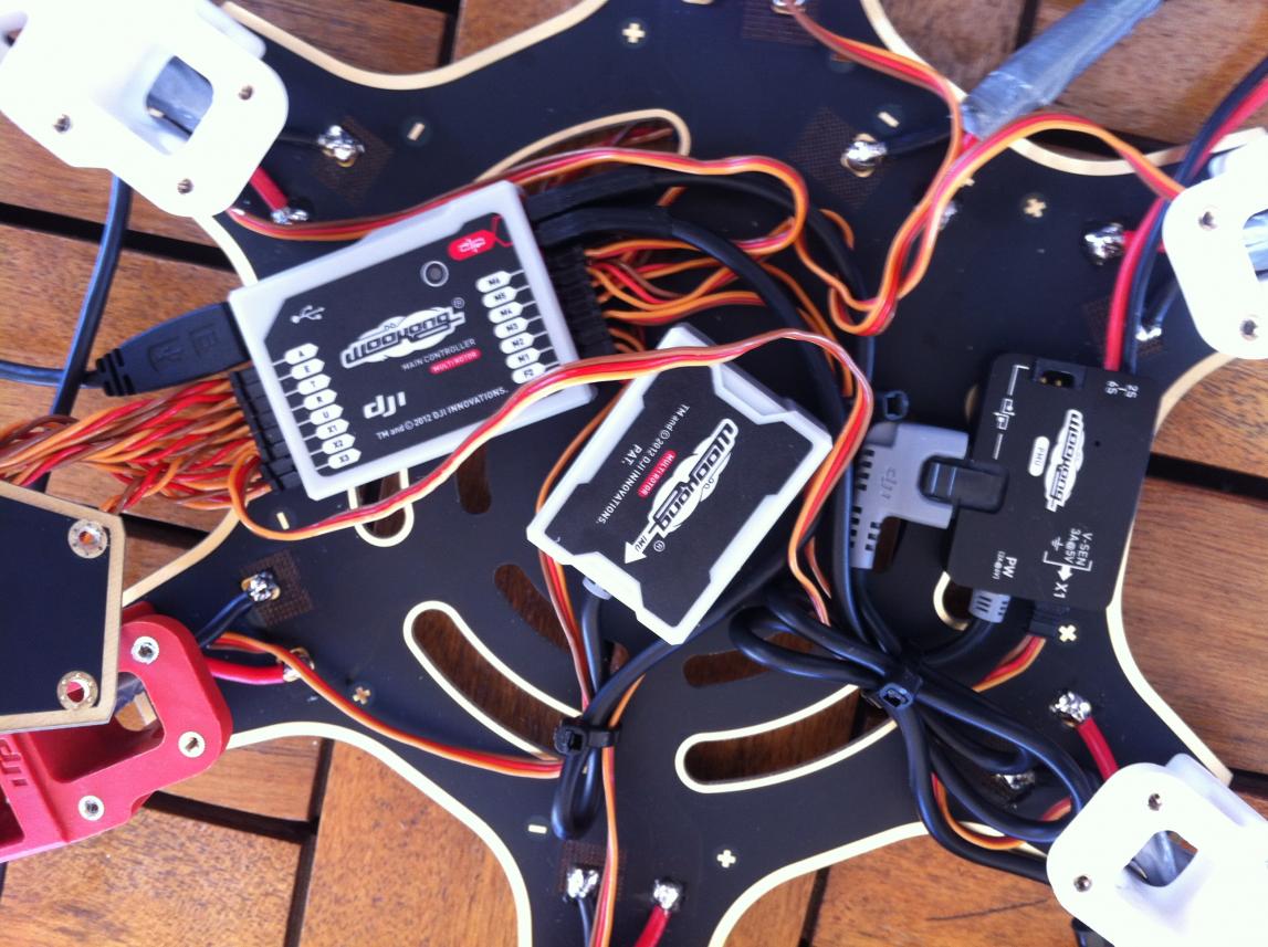

think i see a major problem, what is holding down the naza?
the ar8000 too, why isn't the antenna wire sticking out? what is it touching inside?
The led module shouldn't be resting against any other electronics. put it out on an arm like your sat was, on top, give it it's own arm
