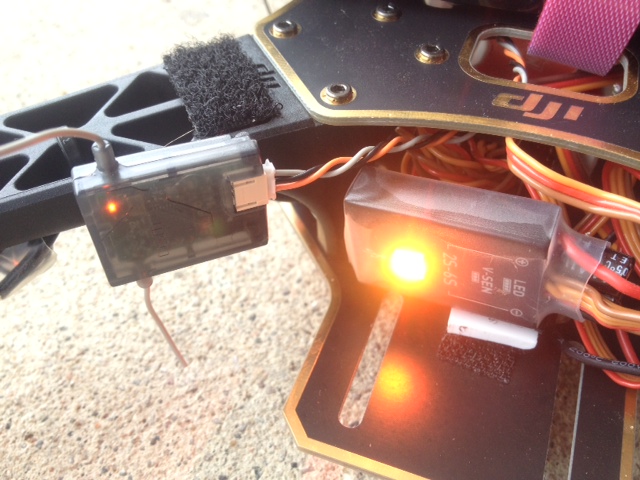

Just tested again, I turned on the DX8, then plugged in a fully charged battery to the 450 it boots up. solid orange light on the satellite as well as the AR8000, but the LED on the NAZA is rapidly flashing orange now and the motors wont even arm. See Image. Thoughts?View attachment 4240

it acts like it will when your missing a wire to naza from the rx
Take the props off, wiggle around your short cables to the naza at it and the rx and see if it arms. Something is way weird
Do you have any servos? You might see if the rc system works on all channels moving a servo from ch to ch. when you unplug the naza form the rx, it'll need a battery like the nimh that came with it or similar or bec. most servos are only good to 6 volts unless they say otherwise
That imu is so close to that rx,,,,, You might also try this, turn on the tx and set it away from the craft, like 10 feet away then boot the craft. sometimes booting too close can cause some weird stuff. It also does that in failsafe or when naza doesn't see an rc signal

need to move the stuff around. most importantly get the naza down solid if your still trying to fly this thing. dunno if you've ever seen a gyro off it's mount and what it'll do, but yea, that thing will slice you open worse than it has if you let it. the imu is a dirty little pig. If your rx antenna wire is stil touching anything, it'll never act right. be like setting the motor in the bed of your pickup and wonderin why it wont go. everything is there, but so far off from how it's suppose to be your gonna see some really weird stuff that isn't usually seen
