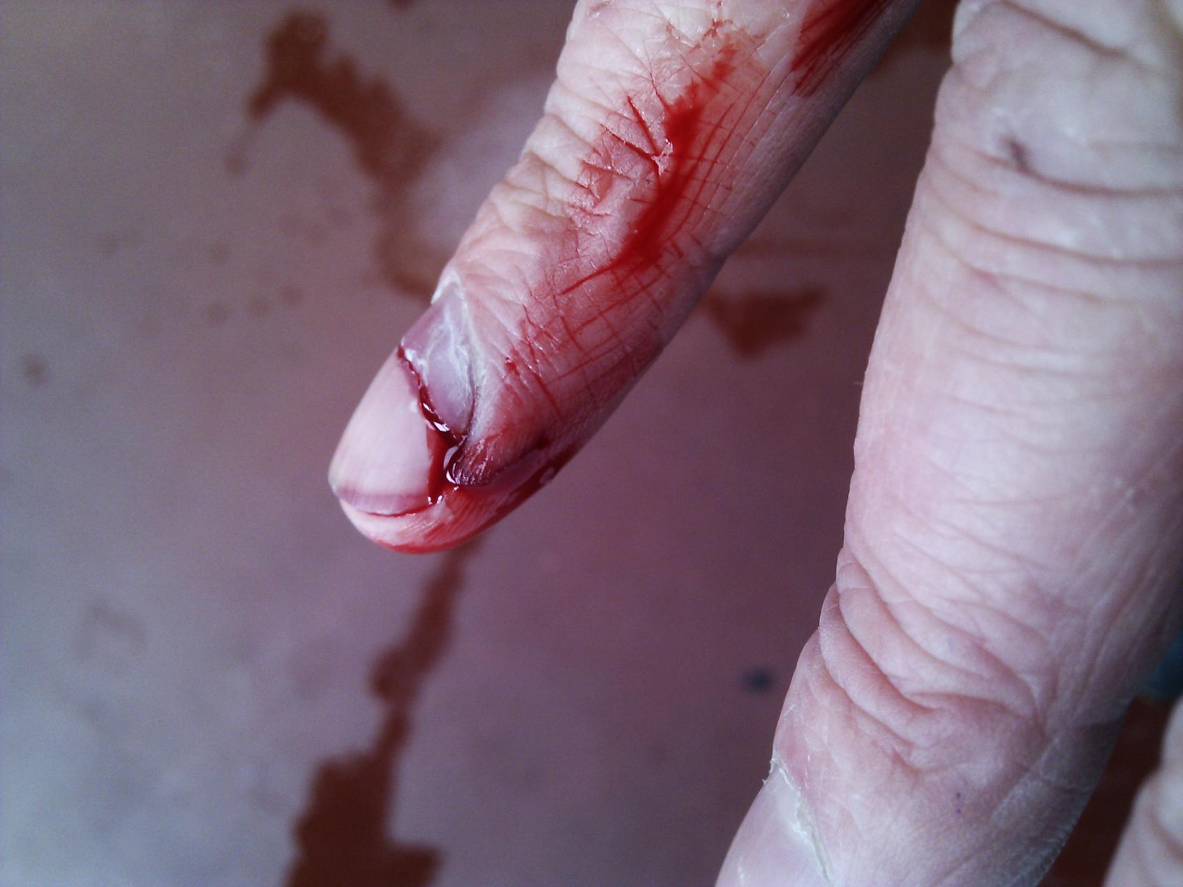

yep those those copter, in the night time i think they go to ninja school. I stuck my hand in to check something, took a hit did not think much about it, until a few minutes later when I looked down to see my finger looking like hamburger meat. There were five slices and with some depth in the gashes.
I am telling you these things are like ninja's, they will hit you and you will not even feel it!!!!
