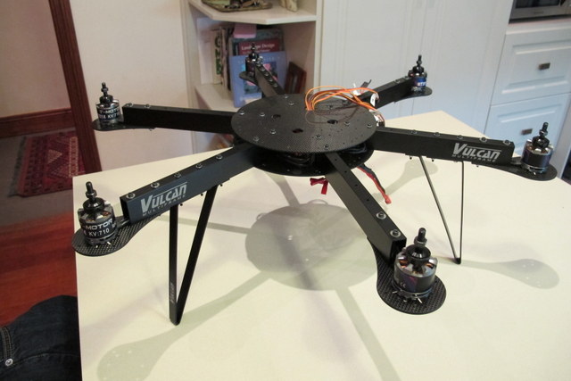

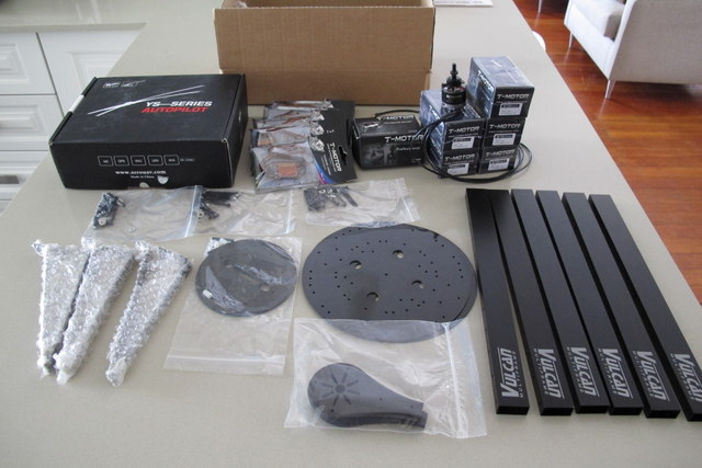

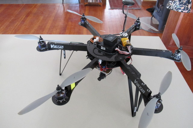

Here is are a few pictures of my latest build.
A Vulcan Multiframe 650 using MT2814-11 motors and the YS-X6 with the 900Mhz data link. Took it for its first test flight today and what a pleasure flying it.
Looking cool Rob. Got any video? I've ordered a droidworx XM-6 frame, and am not sure if I'll set it up + or x. Looks like you're setting the Vulcan up as a +. I'm at a complete loss to find out what is better and why? If I go Y, then I've got a wider window for the camera scope....
Hi Nic......no videos yet :)
I only have a Gopro hard mounted below the Batteries. The position of the legs on the Vulcan makes it virtually impossible to be seen by the camera, no matter what configuration one chooses. So I could have gone for + or X without any problems. If I was flying a 900 or 1200 I would have chosen the X config.
