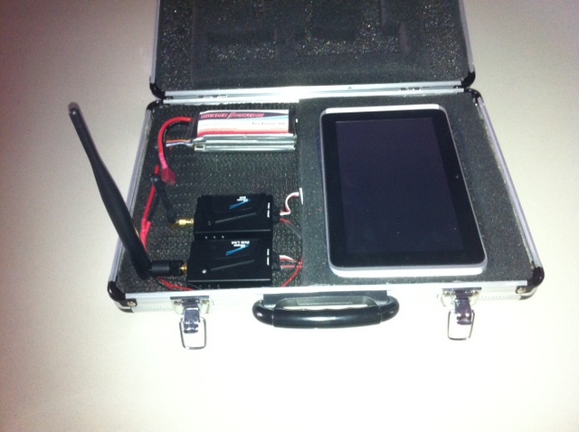

Just for interest here is a pic of my GCS setup in a small aluminium case. The antennas fold down into the case for travelling.
Excellent setup rob... Does the tablet connect to the wifi module so that you can use GCS on the tablet only? I'm having difficulties getting my phone to talk to the wifi/datalink ground package (they are in a box similar). Do you need a hotspot to connect the GCS via wifi to the wifi module in your case? Grrrrr. I'm a little frustrated now, as I've stupidly left the router in the field several weeks ago and dont want to purchase another router.
Rob, a really nice easy to set up and use rig...thats what it should be like....I'm envious. How can we in the UK achieve similar ranges (2- 3 Km) as the achievable distances are 300-500 meters with the 2.4ghz wifi down link and although retailers sell them here we supposedly are not able legally to use the 900mhz Data Links ?
