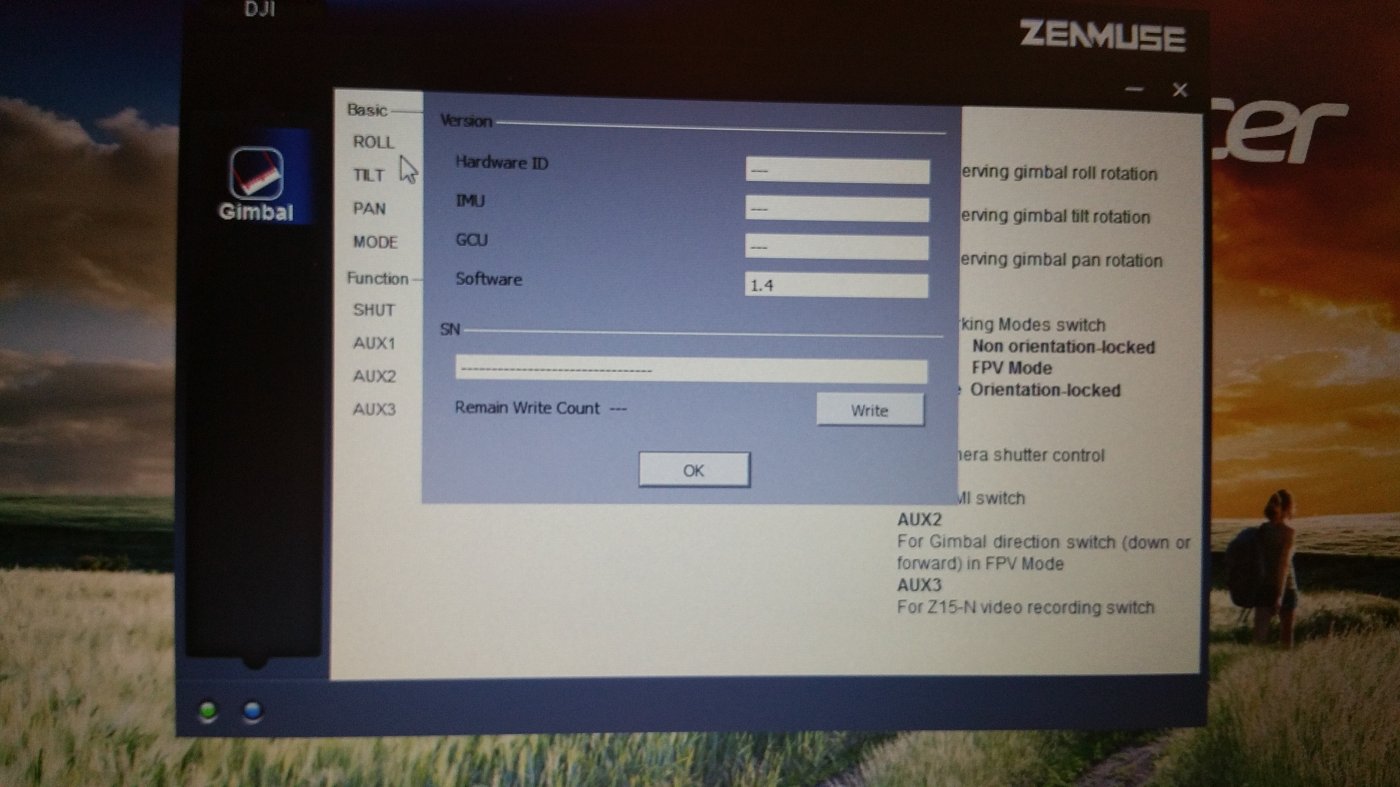

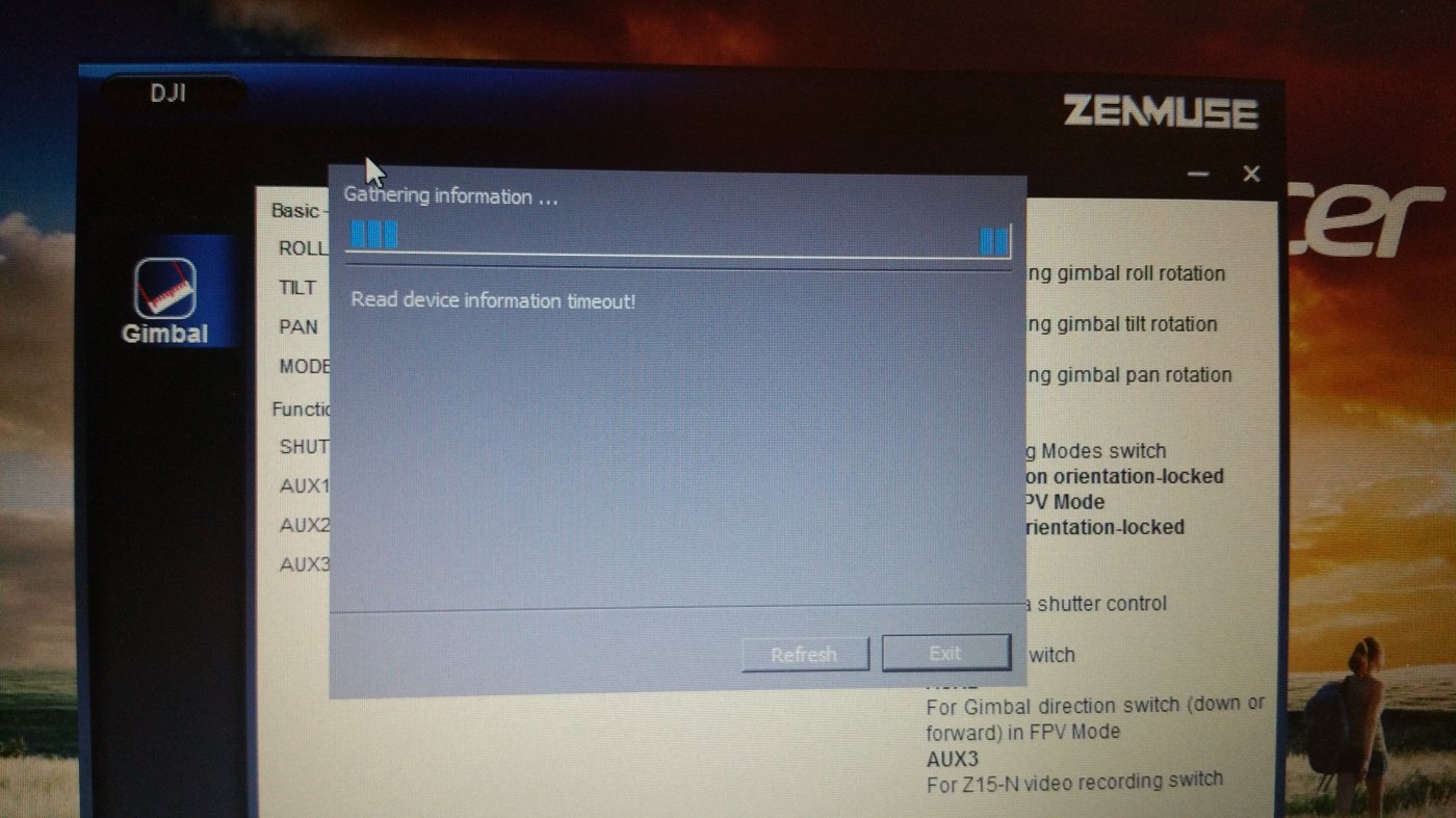

I've tried zen assistants 1.2 and 1.4. In both cases the green light is on showing a connection but the software does nothing. When I move my futaba sticks I see no movement in the assistant. Also, the upgrade process times out and in the about tab I see no information on the gimba .
This is the lattest version gh4-hd gimbal. View attachment 27854 View attachment 27855

According to the symptoms, proper boot up of gimbal, being able to control with futaba etc he feels as though the gcu is doing its job but probably has a bad usb port thus the reason it won't communicate with the assistant. It gets a solid green led but no flickering blue led.
@Hexacrafter, no lightbridge. I tried the ar8000 spektrum reciever with traditional connections. Can't get it do move the gimbal and because I cannot connect to the assistant, it is likely I need to flip a mode switch to get it working. The futaba work fine with sbus bit again, no communication with the assistant.

so 1.2 and 1.4 zen assistant down loaded from the dji website don't work worth a crap. no connectivity. I noticed that the interface of those looked different than the pic of the assistant in the manual. A buddy had a different version of the 1.4 he downloaded a year ago. Yep. 2 different 1.4's. This one works: https://www.dropbox.com/s/9cv1ilvizb3ac2i/Jon McBride - Zenmuse_Z15-GH4_HD_Installer_v1.4.exe?dl=0
I had the same problem a year ago when I couldn't read iosd data files. I found another version of that software floating around the internet (this site I believe) that worked. WTF DJI?
