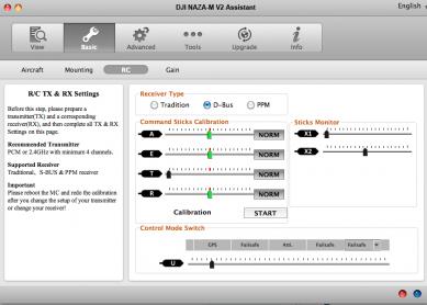

Another small roadblock in the build. No luck with Tilt Control on my new H3-3D Zenmuse. Got the channel 5 set to my "RS" switch on my Taranis. Figured this would be a good knob to adjust tilt slowly. Anyways tried that and a combination of other switches/channels to no avail. I figured I would post my build pics and see if anyone can notice the problem.
attachment.php
Gimbal control is "ON" but I see no X1 available. No sliders toggle X1
attachment.php
attachment.php
SBUS connected to X2. Do I need to switch this for gimbal?
(LED unplugged for reference)
attachment.php
attachment.php
Taranis channel setup
Sorry if I have overlooked something simple here. Got the zen to work decently. Small bit of jello but making adjustments. If ONLY I could control the tilt!!! Thanks for looking or any advice you may have

Turn Gimbal switch 'off' as you are using Can-bus Naza connection to control the gimbal not manual PWM connections,
Calibrate Ch5 X1 movements on RC tab. Adjust end points etc on Tx if necessary.
That should do it.

Thanks so much for the insight. Trying this now. I have my RS slider set to channel 5
Although the only thing I don't see is anything for X1 on my controller. There is no X1 movement in Naza when I look at the sticks moving. Nor do I see anything to calibrate X1. I can see X2 move with a certain switch. Not X1 if that makes sense
On your Tx can you monitor your RS slider movement on screen (I can on Futaba 10J) is it actually enabled, transmitting?, sorry don't know your Tx/Rx.
I use Pc not Mac ver of Asst, but does the 'start' button on your screenshot of Naza asst not allow you to calibrate ch 5?
Until you can see/get slider on X1 to move on Naza Asst, H3 gimbal tilt won't work.
Sorry struggling to help further.

Sorry, on a Frsky Taranis.
I don't see anything to calibrate channel 5 or X1. Actually I can toggle every switch on my controller and no X1 movement. Maybe I'll update my Naza to the latest and see if that changes anything. Just saw there is a new firmware in Naza v2.

Tilt control set to channel 5. Assigned the RS slider knob for tilt. No movement whatsoever. In naza assistant the X1 and X2 switches show NO movement at all. Don't get it

As above, turn off the gimbal switch screen, not needed for the Zenmuse. There's some help here. It says you should calibrate the X1 channel.

Great. Got the gimbal switch off. My problem is that the "X1 Calibration" isn't even showing up in my Naza assistant.
-X1 Calibration must be the problem
I've read so many people get it working after this calibration. Why would mine not even show up on naza? Not sure whats going on here, something doesn't want me to tilt my camera lol

Did you read through the post I quoted? Have you deactivated X1 for gains adjustment in the other screens on the assistant?
Thanks for the post. I am not sure how to deactivate X1 as I just can't find ANYTHING X1 related for some reason. Can't find X1 in my Taranis menu, or Naza assistant. I can see the sticks monitor on Naza assistant showing an X1 and X2, but the black bar never moves. No motion from any switches.

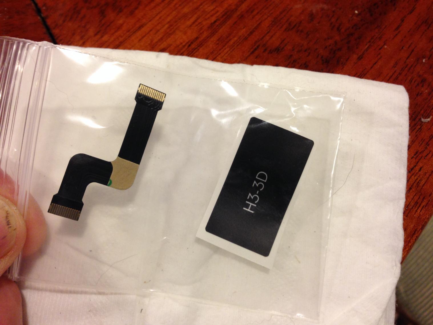

Anybody have an idea what this is? Came in the packaging for my H3-3D, non-Phantom 2
attachment.php
I don't see anything in the manual that refers to this connector.

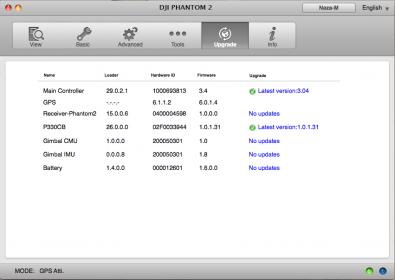

Also, when I power up my P2 and go to the info page I can see all my peripherals, Main Control, GPS, Reciever -Phantom2, P330CB, Gimbal IMU and CMU and battery but when I go to info on a DIY quad using NAZA M with PMU V2 upgrade, iOSD mini, Zenmuse H3-2D, and a Can-hub to connect them all I only see the Main Controller, GPS and PMU, nothing for the Zenmuse CMU.
