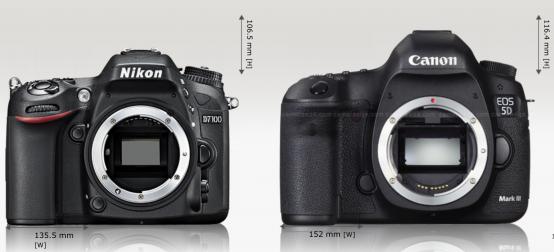

Howdy folks,
New to the hobby (well, I've been into RC planes and helis for a long time and into photography but I'm just starting to combine the two) and new this forum.
I did do a search and didn't find anything but I'm wondering if this gimbal (or any other DJI compatible gimbal) fits a Nikon 7100?
Thanks!
Ryan
Perhaps the gimbal made for the Canon 5D would work - here's a size comparison of the two.

allbread
Actually, the more I'm reading about the GH4 the more I'm thinking I might get it for dedicated video/aerial and use the Nikon for dedicated stills. Videos that I've seen have been fantastic, it's not near as much as a Canon 5D and, unlike my Nikon, they obviously make a gimble just for it!
