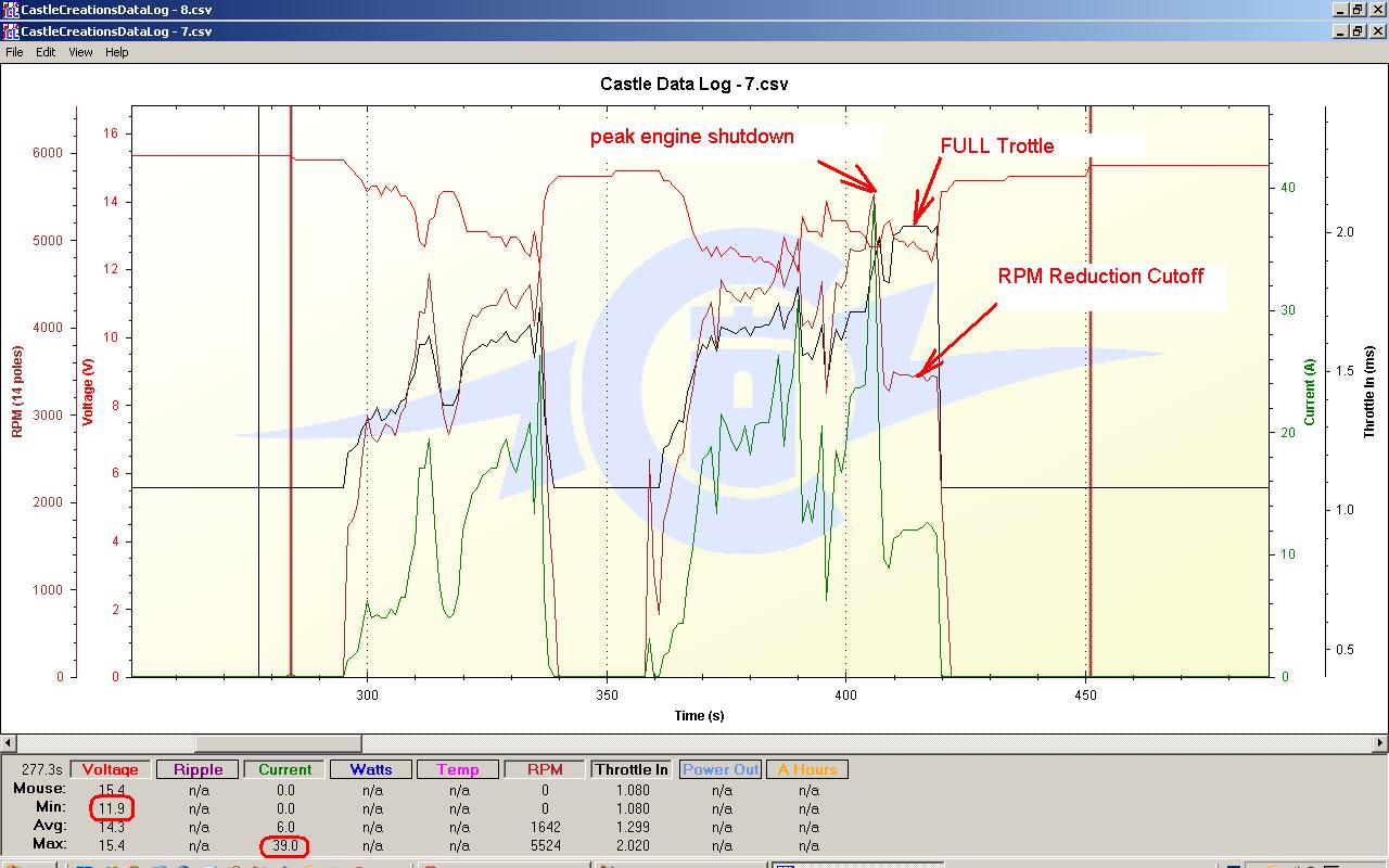

there was a problem :(
Starts all ok. but 80% of the trottle (kopter keeps assistant) multiple engines are cut (not cool) .... the battery cables hot (12 AWG)
timings CC exhibited in mid
(14x4.7 props, motors are: QC-3328 http://www.quadrocopter.com/QuadroPower-Motor-QC-3328_p_392.html
BATTERY 4c 11,000 mAh)

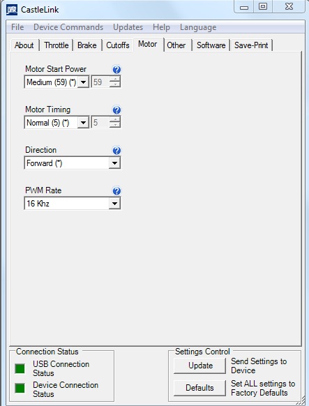

please tell me the СС controller settings (PWM Rate, Motor Start Power, Timing)
I have checked all the settings and do not know what they were by default ..
Kari
Haha, accidentally posted my flight ticket first :D But here's my settings.

With these settings, and 8 motor installation consumes a lot of power.
XT60 connector almost melted. Had to install Motor Timing to 0.
Looked through the logs from the controller, then why get a large drawdown of battery voltage (MaxAmp 11,000 mah), I realized there is a trip because of this (reduced engine speed).
That's what I'll try to do it:
1) rewire connectors XT90,
2) put 10AWG wires
3) try to establish two parallel battery
