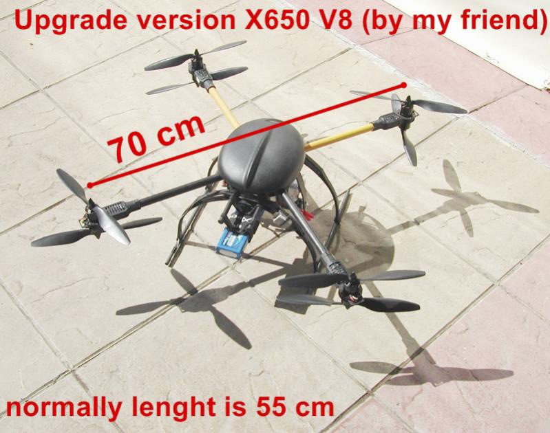

Hi, I had an interesting chat with Adnan, who runs the fpvhobby.com in Istanbul/Turkey about an modified x650 V8 with longer legs between two motors. Normally the lenght is 55 cm between 2 motors. A friend of him added longer legs on it, so the new lenght is 70 cm. He is able to lift off a Canon 550D and he said it's much more stabil to fly. I want to put this issue into discussion. He send me that picture to illustrate it. What you think about? cheers Fabrizio

I have a 650 quad that I think these machines would be much more stable if they had longer arms.
I was even thinking abit longer than he suggested.
Has anyone out there tried putting longer booms on their machine? If so, how did it work?

Yikes that's what happens if you go with longer arms? That was a wicked crash!
I went with the X650 frame and Naza FC. I'm now trying to figure if the longer arms would help?
I feel the longer arms would really help if all set up right in the Naza setup assistant.

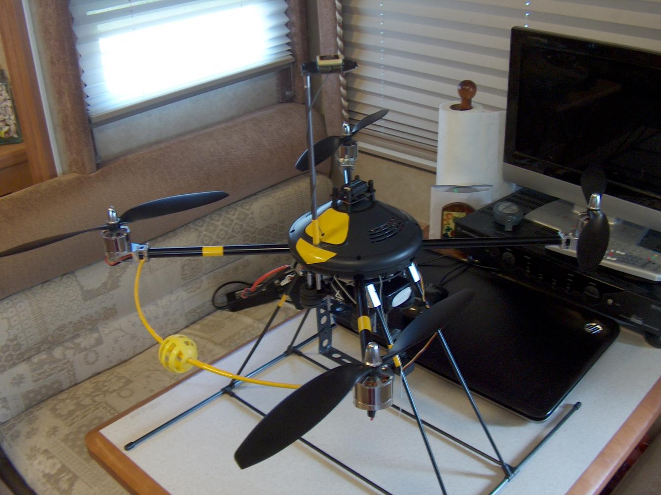

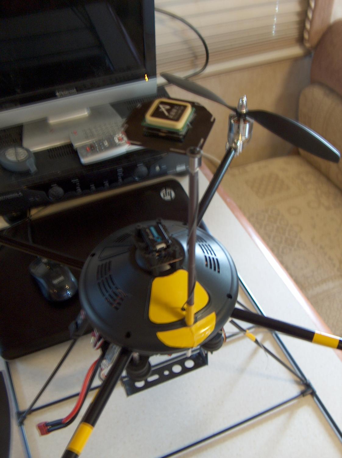

Hi chris11414
Just cruising down the thread and see you asking about placement of GPS which is why from your pictures your not getting reception and locking. Please see my picture attached of my quad. Notice where the gps is. I get 224-240 pacc at that location with lock in seconds on 5 sats and 9 sats within 30 seconds. Hope that helps. I have a folder I email out with lots of info on your FC1212-S system if you would like a copy.View attachment 4512View attachment 4513
