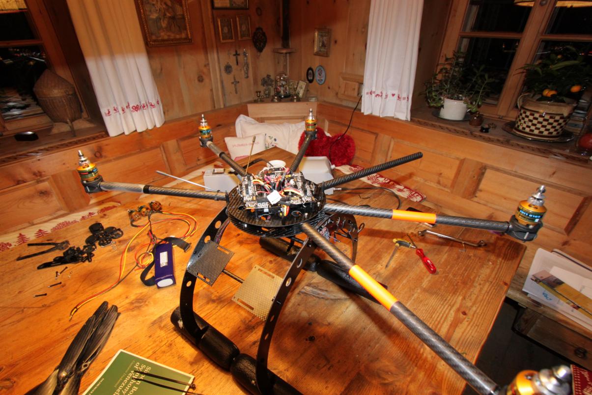

still doesnt respond to well at all. heres some pics of it for reference. ill have to shoot a video of the problems

the top motors are set up like this
bottom one spins opposite to the top and has the opposite blade as the top
Should be right! Right?
the bottoms should each spin opposite of their top neighbor but the props should be installed the same right-side-up way as the tops. if the copter is on its back and you're installing the lower props, you should be holding them upside down as you thread them on so they're right side up when you turn the copter over.

looking at the top two pics again it looks like you've got them on correctly.

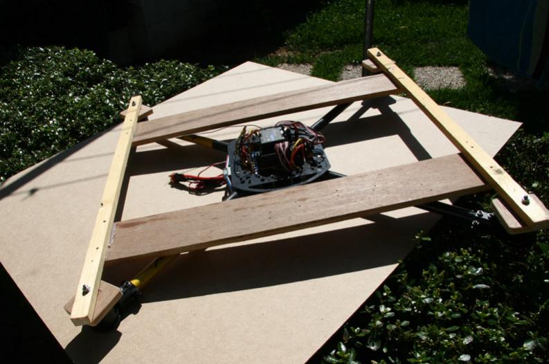

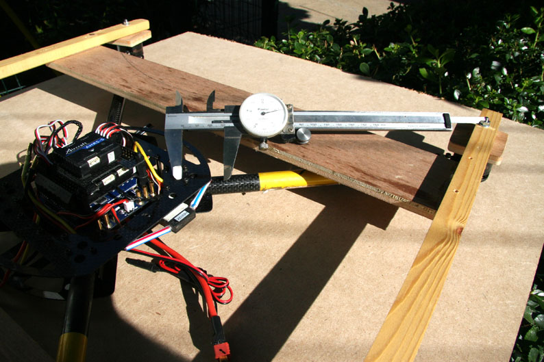

Hi guys,
After reading this inbteresting thread, I thought I ought to share with you this experience.
After several crashes and repairing one arm, I decided to make some geometrical measurements on my x650 and surprise... it was all wrong. Different distances between axes, arms not ortogonal, etc.
So I decided to make a geometrical gig according to the general dimensions of the copter, losen all screws and correct the full geometry. Didn´t test it after this. I will do it soon. But knowing that you guys are making ajustments on pid and configuring rc, just have a look at the photos. I corrected distance between axes and centered the main body in the middle.
Hope this helps someone.
CMonteiro
View attachment 775View attachment 777View attachment 776
