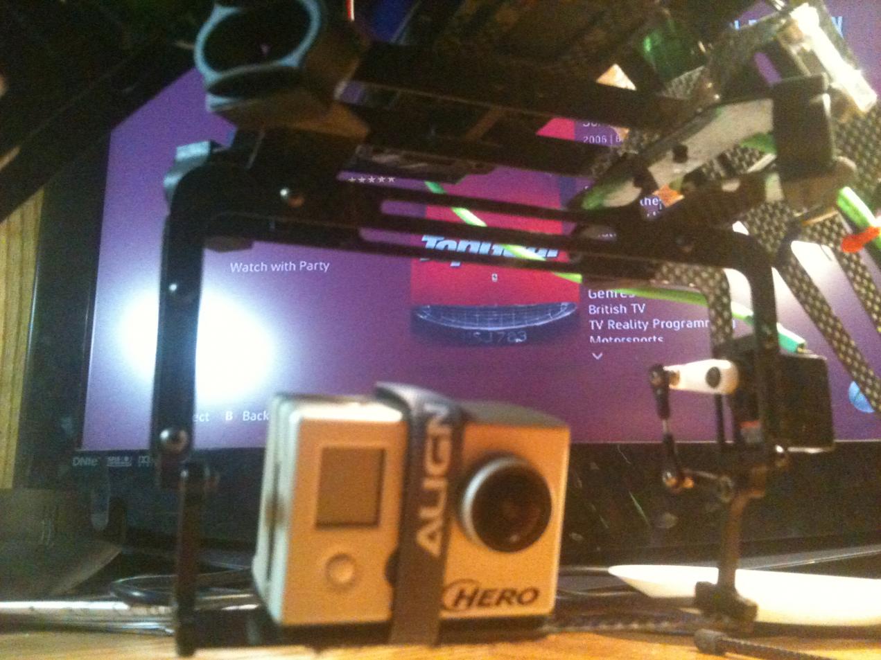

had to change something. not happy with images coming out of the normal setup

Nice, I've been thinking about doing the same thing... Does it not effect the handling of it ?
can you perhaps post some more pics ?
it works perfect, I will post some pics tonight if i can. all i did was took four extra booms zip tied them accordingly , so that its balanced and removed the battery tray and zip tied that to the rear boom and put the velcro back on. and then just make sure everything is balanced . i cant believe the difference in video

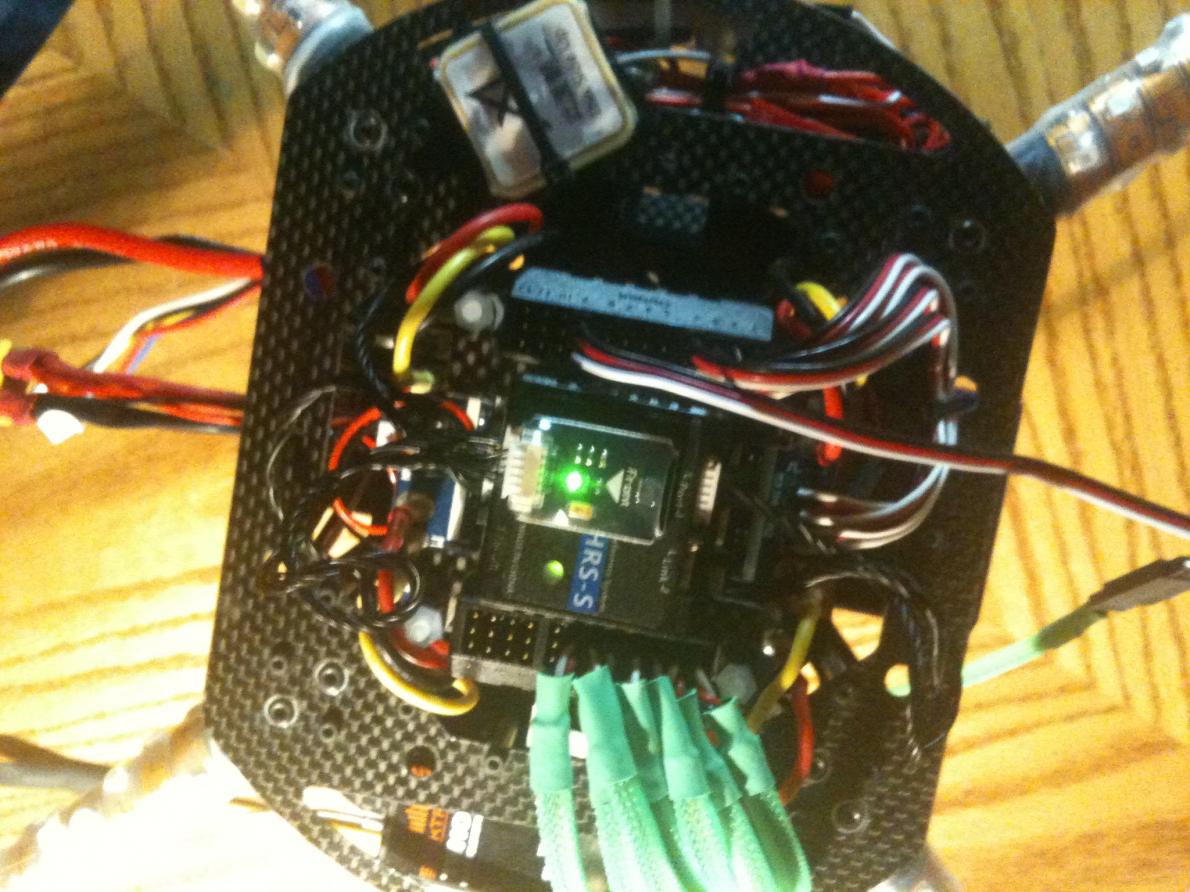

Hey Guys! I was surfing the web and found your thread! I would like to work with you guys so we can make these PID tuning more easier then the Trail & Error. I found online how to tune the x650, but its Trail & Error! I dont want to risk crashing and rebuilding my copter just because of some wrong PID values. So I want to do some MATH, work with some formulas and numbers so that I can have the correct values for my X650. So I am wondering how xaircraft on their site where you download the setting, how did they get those PID values? I have surfed online to find a formula for PID tuning, but it so complicated! I wish there was a simpilar to get the correct PID values so that we could calculate the weight, power from the battery and power from the motors, so we can change the values and ready to fly! I like how with the hoverfly boards, you dont have to worry about the PID values. You would just adjust the channel parameters that is associated with the hoverfly feature from your remote then worry about the PID setting on the computer.
SO I join you guys in this thread because im having the same problems as you guys are having. I have recently finally installed my GPS and compass, but I'm having my X650 oscillating, drifting a lot and motors being really HOT! Im guessing the drifting I could fix like what you guys have done, to recalebrate the AHRS on a level surface and make sure the mounting in the x650 is aligned with the motors. But the motors being really HOT, Im worried about. What would be the max take off weight for the x650? Is it really 1400g? I measured my X650 at 1600g with a 4s 5000mah, lights, cam mount, gorpo (everything you see in the pics below). How much does you guys X650 weight at now?
View attachment 349View attachment 351View attachment 348View attachment 350View attachment 352

chris11414
I have recorded a video with my Gopro on the X650. You can see how im having trouble keeping the copter level and to have the copter keep its altitude. I had the GPS installed, but it wasn't working because it couldn't pick any sats. I need to relocate the GPS antenna because I have it mounted next to my FC like in the pictures that I posted above.

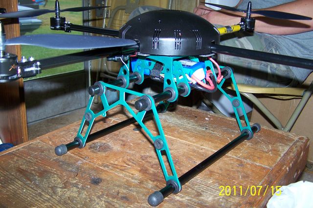

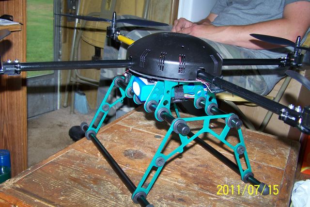

New Landing gear for X650
No Bart I bought another....right before my pre ordered gps/compass came.
I had an extra set of landing gear off my hexa that got shocked had to do a little straightening and paint but the 4 main screws lined right up with boom blocks and wallha got me some new shoes.....lol
